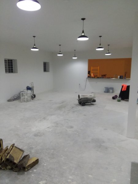

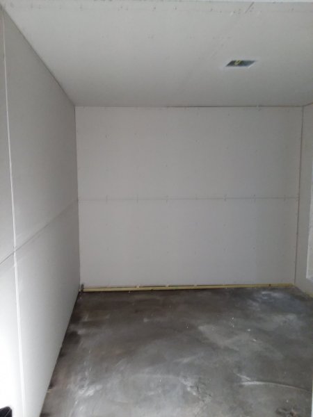

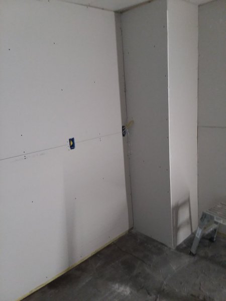

    getting closer. these are from 2 weeks ago, didnt get any from this weekend but we finished the drywall in that small room and pretty much have everything cleaned up and moved out of the retail side of the building. AS 057.jpg AS 060.jpg AS 062.jpg AS 064.jpg
