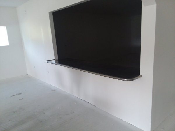

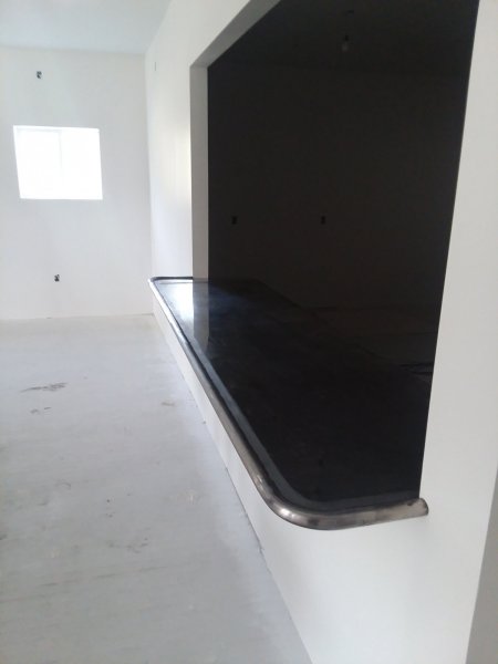

    made a little progress in the last couple months. Stainless counter. Not perfect but it was a trade on some work we did in the shop for a welding/fab shop....by the time they actually made the counter for me the owners had parted ways leaving the guy we did the work for gone and the the remaining partner doing work for free.

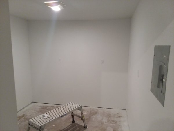

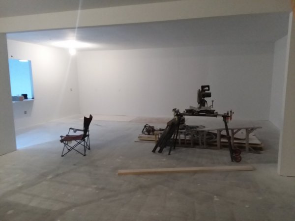

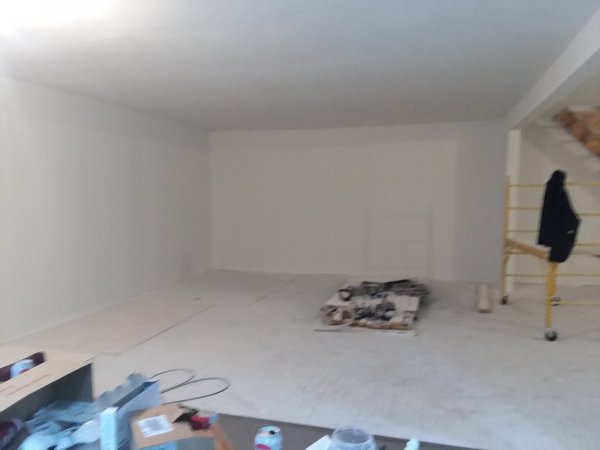

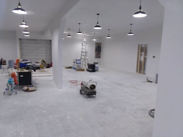

    and here is the rest of the building. finished up the last of the outlets and lights last night.

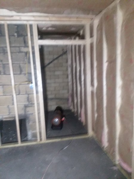

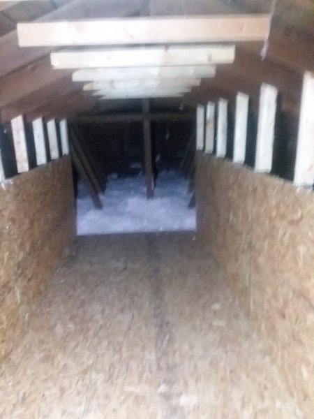

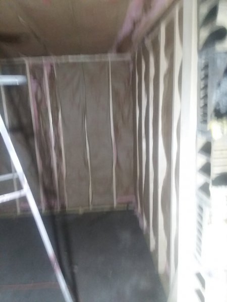

    worked on the building some this weekend. sorry for the fuzzy pictures, didnt notice all the dust on my phone until just now. Will get some better pictures next time i am out there.

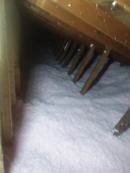

    14-24" of blown in fiberglass, planning on adding more to make it all 24" when we get to the garage side of the building but for now this will have to do. i dont recommend ever using atticat insulation and blower.....70 bags of insulation at a rate of 7-8 bags per hour....it was like watching paint dry
    Not sure how a torpedo heater compares to a regular furnace but a 75000 btu torpedo is able to raise the temp in the building by about 2-3* per hour which i considered pretty good considering it was low single digits with plenty of wind this weekend. Still debating what to do for a furnace.
    heat load calc says 100k btu for heat and 13k for cooling.
    I am kinda leaning toward an 80k furnace with 3 ton of air with the assumption that once the building is filled with stuff to help hold the heat instead of just being a big empty room that it will be enough, the other reason is that and 80k with 3 ton can be had for $2600 vs 100k with a 4 ton is $3200.
