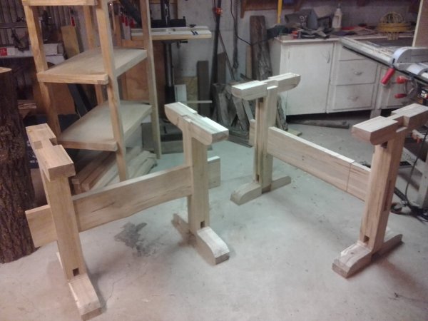

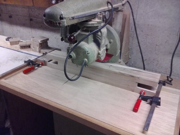

    I worked on the parts for the table some more today. The legs needed a 1-1/4 x 7-3/8" mortise for the stretcher. Those took 4 separate operations - perfect example of things taking longer than imagined.
    I used a hollow chisel mortise setup on my drill press to chop the short sides, and I used the radial arm to make a plunge cut for the long sides. Then it still took 4 cuts with a jigsaw to free the plug and some chisel work to clean everything up.

  13. Eric VW
    24,565
    141,728
    Those will be the premier spots to sit at in the whole joint! Excellent job so far Shawn:thumbs:
