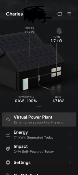

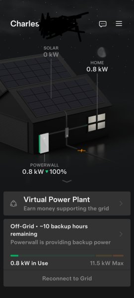

    Hey all, I've been in and out of this thread for years now.
    I got my system installed on Tuesday, and so far I'm finding some interesting things.
    It seems my house is Way more efficient on solar than on the grid.
    I'll try to post pics..
    With solar, pulling from the Powerwall, disconnected from the grid .
    Now, while still sitting in bed, not changing any conditions.. reconnect the system to the grid..
    So, I went from 0.8kwh on Powerwall battery, to 1.7kwh on the grid.
    All while sitting still, not changing anything.
    Makes me wonder WTF is going on.
    If any of you have seen this and have an explanation, this novice would be happy to learn.
    Thanks

  20. bogieb
    12,599
    76,637
    Fridge and or freezer started up at a coincidental time? Do you have a well pump that would fill the bladder tank every once in a while?
