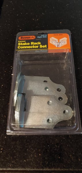

    Picked up a set of corner brackets last night at Northern Tool. 1120220851.jpg
