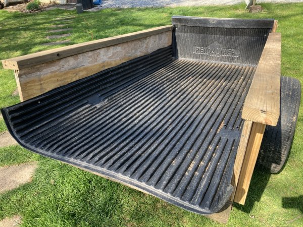

    Awesome transformation of said new wood hauler. I never thought of repurposing a drop in bed liner, really like that idea.
  5. The Wood Wolverine
    18,998
    122,731

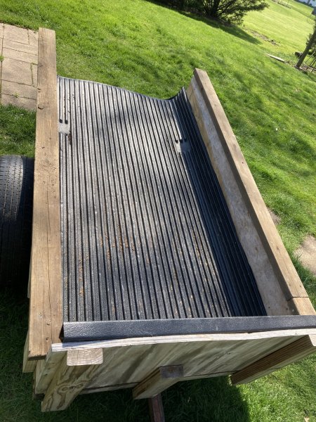

    Been doing that for a while now, in my wood wagon and my road legal utility trailer. It makes cleanout crazy easy and keeps weather and sun off the wood deck. I just back up to my burn pile and stuff slides right out. Then fingers go down in the grooves to get all the fine.

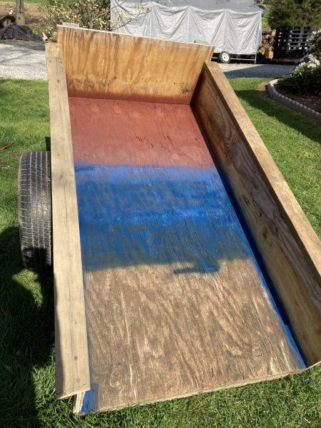

    When I first did it in the Snowbear, the plywood decking was getting old. That was many years ago and in fact, I've never changed it since I bought it. I occasionally remove that one to get any debris that collects on the sides. Plywood hasn't changed.
    The wood wagon liner was cut in a way that it has a couple inches of side coverage. It's deck is treated ply. A ccouple months ago, I checked it. And I did a paint can clean out. Used up some older cans before they went bad. I figured it wouldn’t hurt. Wood was solid and not much different from when I added the liner. I'm sure it's not moisture proof though.

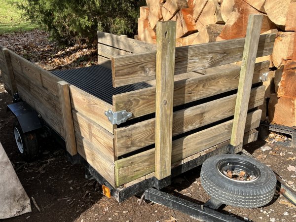

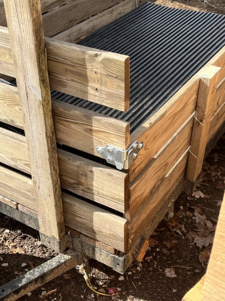

    So I tried to get these at TSC this last weekend. Website said my local had “1” in stock. Went there and they didn’t have any. Price was over $30 and unclear how many pieces were included. So I ordered elsewhere. Got em and installed today.
    CBF1B583-D2C5-42EE-86B7-5301FC9BBC6C.jpeg 8098A687-E833-4059-8584-3FBB9E6138AA.jpeg
    Also cut off the top row for ease of reaching in. Corner pockets were definitely needed. Thanks for pointing me in their direction! :handshake:

    Same corner brackets I got on my trailer. They make all the difference in both form and function on those corners Jason. Really looks nice!

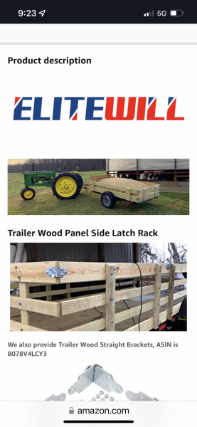

    I got these:
    $17/18 for 8 pieces plus nuts and bolts.
