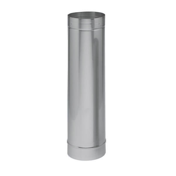

    instead of installing a flex liner with insulation
    could a rigid one be installed?
    diff between 304 and 316stainless alloy
    wrap with insulation or pour vermiculite or something else
    Marvin, Horkn and mat60 like this.

    Now I'm thinking break up old flue liner- I'll weld up something to do it and make extension rods

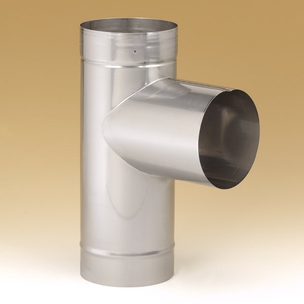

    New clean out door but opening will be much larger with removal of double door size of bricks. Then cut thru inner cement block, might even be able to get a stainless T in this way.
    Rigid stainless stove pipe riveted together and insulated. Fed down from top. I think I could get 12 ft pre made and lifted to drop down. Install T and hook up to stove. Insulate around T put cap under it.

    Sounds like a good plan, and they sell the two part T so you don’t have to do any cutting to fit a one piece in there if you’d rather go that route. It’s what I went with and am happy so far. Saved me a lot of extra work and very rigid once two parts fastened together. This pic givea you an idea of how they work. Keep us posted as the time nears! Be neat to see what all you decide on:thumbs:Google Image Result for https://www.rockfordchimneysupply.com/pub/media/wysiwyg/images/rockford-art-tee.jpg

    I originally thought to do completely new. But now after discussion, I am thinking of dropping rigid stainless down existing chimney.
    I guess I could cut in a new higher door and drop down rigid stainless pipe without removing all clay liner run it for a year. I could always pull up stainless pipe breakout all clay liner and re drop pipe but now insulated.

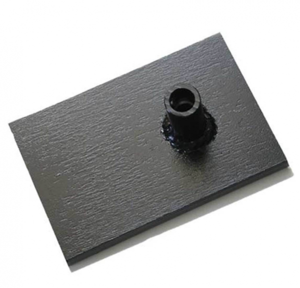

    Found this larger clean out door. I could install.
    It could give me a better angle for feeding cleaning rods up chimney
