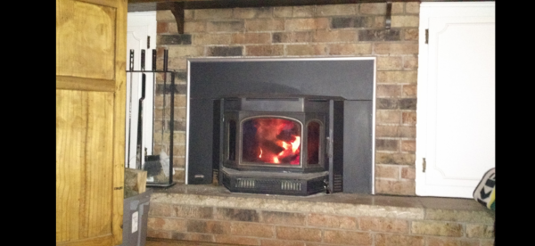

    Yeah, that Rutland 1/2"-5/8" gasket makes the door super hard to close. We'll see, but I may need to go a size smaller. 1/2" should make it work better. You can't stretch the stuff I got to stay in the smaller 1/2" diameter, not with getting it to stay on the door at least. I know I like the grey rope gasket and but the bright white stuff that I was sold originally. Granted the stuff I bought before was way too wide diameter. 3/4" does not fit, I'm sure of that.

    The gasket is slowly getting better with time, as far as the door closing goes, but I still think I'll need to put in 1/2" stuff. The latch doesn't close like it used to, and as it is, my wife won't feel comfortable reloading the stove.
    That's a deal breaker.
    The glue I have from Gaskets Inc while kinda a pita because it's very runny and this is a bay front door and it's not flat, at least did as they said and could be used within minutes of installing the new gasket.
    It's kind of difficult to keep a runny liquid on the two 45° ends while the front flat part is how it is when the door is on its front.:hair:

    My door is not flat, seeing that it's a bow front door. So even off the stove the due is impossible to have it lay flat.
    So those two "wings" on the ends are at 45° angles or so when the face is flat.
    Easy solution, it's too buy a door gasket glue with higher viscosity. The Rutland red stuff is like an rtv, and should work well. The door is a little easier to latch this am. We'll see.
