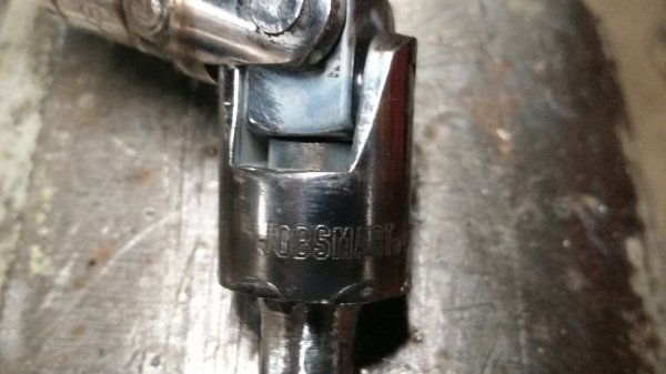

    I ended up with the Predator 6.5 hp engine. It takes quite a bit to impress me, and the new engine has so far. The bolt patterns lined up exactly. The shaft lines up exactly with the belt. The shaft pulley fit fine. I only needed four longer bolts as the engine base is thicker, and the end shaft thread was 5/16 -24, different than the old one. The belt keeper fits, as well as the belt cowling.
    The only modification I have to make is the chute directional shaft hits the side of the engine. The Predator is a slant cylinder towards that side. The Tecumseh was a straight up cylinder.
    So where do I get a universal to make the corner for the 3/8" shaft? Tractor supply had 3/8" socket universal, and some welding got me this.
    Notice I set the shaft in too far and welded it to the socket. The shaft bottomed out against the inside of the universal.:headbang: I was being careful to keep the shaft centered in the socket when I welded it. I popped the pin out, ground the excess shaft with a wheel and reset the pin. I'm trying really hard to not be a terrible welder.
    I just need to re-align and make a second part of the upper bracket to take the slop out of the shaft. Maybe replace the plastic bushing on the shaft too.
    I'll fire it up tomorrow afternoon.

    Hey nice work fishingpol! I had to modify my shoot control as well, it I got lucky. I was able to simply rebolt the original bracket through a different mounting hole at a slightly different angle and was able to sneak it by the engine. Glad you got it done.

    That looks really good. I'm really impressed with the 6.5 hp predator on the splitter. It was super easy to repower.
