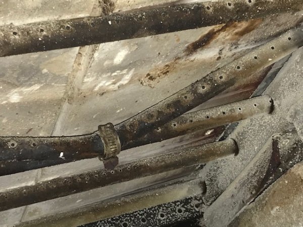

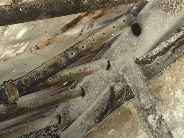

    Bent tube #3 popped out of it's hole today and I replaced it this evening. When I put it in a couple weeks ago, it was fairly straight, but it seemed like every day it got a little more bent. Pretty sure the heat cycling walked it out of the hole on the floating end.
    Very bent...
    Almost straight before it went in a couple weeks ago.

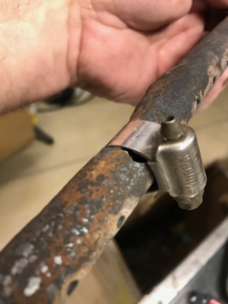

    This was a salvaged tube from an earlier replacement. As they bend, the backside blows out with a gaping hole in it I mostly covered up with a SS hose clamp after straightening the tube the best I could. It worked to get the new replacement ordered and shipped. I ordered a spare this time so I should never need to replace any again... :D
    I sanded the floating end of the new replacement down a little so it wasn't such a tight fit and looked up in there after I got the stove back up to temperature on the secondaries. No leakage flame by that tube end so I didn't get the fit too loose. This summer when I clean the stove out good, I'll check all the tubes for a loose fit on the floating end.
    Secondaries are all firing up like they should now. :yes: :MM:
    brenndatomu likes this.

    Wow, those look roached!
    Almost don't even look stainless...

    If you notice in the first picture, the firebrick keepers are burning away... When the stove was new and I put it in 5 years ago, I noticed that the keepers were made from like the "live edge" scrap ends of steel coils and weren't all that nice looking then. I didn't think too much about it cuz they're just holding the firebrick in. At this point 5 years in there are a couple spots where they are corroded away so bad that the firebrick could fall over. The wood and coals keep them in though and I'm careful when raking the coals forward.

    Yeah, those don't look like stainless.
