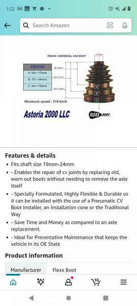

    This is the style boot. This universal type that can go on many different size axles but in the description it even talks about these boot stretcher things and being a more flexible boot. Screenshot_20240130-012240.png
