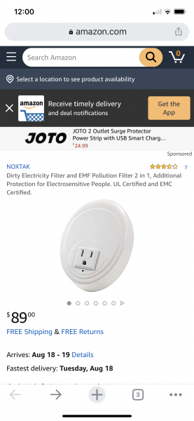

  6. Canadian border VT
    19,690
    131,087

  7. brenndatomu
    25,199
    163,912
    Chvymn99 and Chaz like this.
  8. Semipro
    Semipro
    Jan 26, 2018
    185
    751
    SW Virginia
    Or more generically, a "power conditioner".
