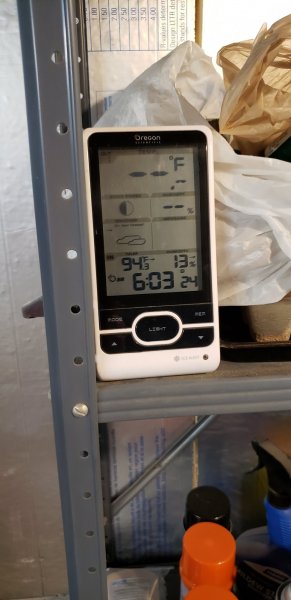

    I would say so...at least when the furnace is not running. Probably more like 5* when we all take baths/showers close together, and then more like 1-2* if it just runs a quick cycle from doing dishes, or a quick shower.
    The humidity in the basement is running 50-55% (according to my cheap digital meter) depending on what the weather is doing, and how much the HPWH has run recently. I know it sure feels good down there when you walk in from outside on a hot day! :dennis:
