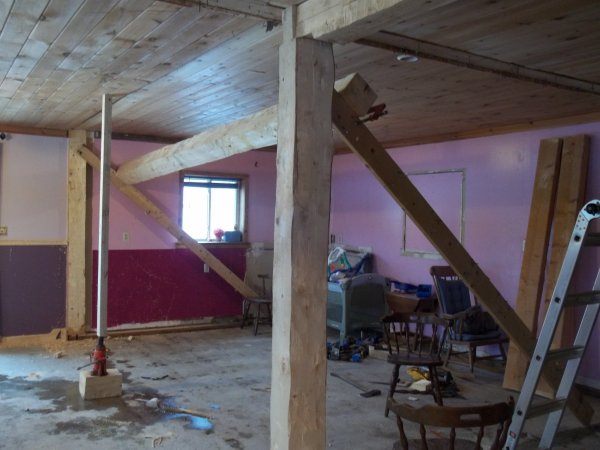

    darn heavy seems to be an understatement for that beam. Good on you two for getting it done. I got a chuckle out of the temporary posts on top of the jacks. They don't look to be very light either but very "artistic".

    Well in trying to do a really good job of giving this 100 year old house another 100 years of life, we tore down the ceiling to see why the second floor was sagging. It did not take a structural engineer to figure it out.
    Around 1946 the house was renovated and a load bearing wall downstairs was removed from the building. In addition a wall was put upstairs halfway across the room. While not intending to be loadbearing, it ended up being just that. This left the entire second floor to span 18 linear feet, with a cutout for a staircase with no header, with a wall bearing the weight of the roof and second story above.
    All this was held up by 2x5's spaced 2 feet on center! Is it any wonder the floor sagged in the center by 2 inches?
    Naturally the beam we put in where the old load bearing wall once stood will help a lot, but yesterday I sawed new 2x5's, jacked up the floor stringers from underneath and then nailed in the new floor stringers (Spruce) to each side of the existing ones. That will net me laminated carrying stringers that are 5x6's, 2 feet on center with a 11 foot span. Its not ideal, but a whole lot better than what was there.
    I have no idea why the second floor did not come crashing down onto the first floor. All it had was (2) 20 penny spikes holding it together by the stairwell, not to mention one knot on the bottom of the stringer blowing out and causing a cracked floor stringer.
    On a great note though, it is a good thing I got my own sawmills to saw out these oddball sized lumber sizes; 2 x 5 is not exactly standard size lumber! On a bad note, one of the spruce logs had nails in it which caused the sawmill blade to complain a little bit!

    Even after cutting the span back to 12 feet, and tripling the 2x5's, there is some bounce to the floor hen you jump up and down on it. I probably should have sistered on 2x8's and then covered difference with a board, or added a 2x3 in between to make up the difference for the existing stringer.
    I have to be careful because being cottage style, it is structural, but also finish carpentry, meaning everything is exposed (no ceiling). But it is too late now. I am going to tear into the other half of the floor today and do the same thing to be matchy-matchy.

    Brand new houses with those fancy laminated beams- floors go bouncy as well. Fire department horror stories about those.

    Framing wise, I got everything beefed up with the second floor, floor stringers beefed up with three times the strength they had before. Framing also meant changing the layout of the house. The old living room is now the kitchen, the old kitchen is now the living room, and the bathroom is a bathroom/utility room. This included bringing the well tank and hot water tank out of the basement so no utilities are in the old fieldstone basement. Kitchen wise, we reused the kitchen cabinets (for now) until I can build new ones. Yesterday we hooked up the plumbing though, and for the first time in a decade, the pump in the tank spun and water flowed into the house. A house just is not a house without running water!

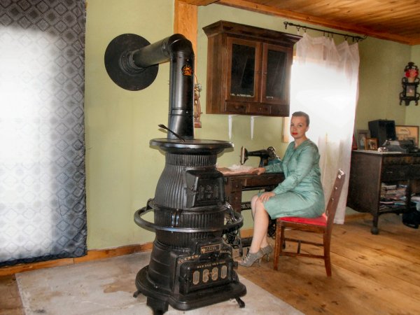

    In addition to what Woodwidow said, warm floors are always great to have in winter. One of the reason I run the P61a to heat the basement to 72* is so I have warm floors in the kitchen, living room, office and bathroom (bedrooms are over garage - those floors are cold :(

    Eventually we are thinking about putting in 100% radiant heat. In this house it would be really easy as the underside of the floor on the bottom floor can be accessed by the basement. Then upstairs we could just run pex over the top of the floor and put down new flooring. I have a rebuilt wood/coal boiler for that if I needed it, but unsure if all that is warranted at this point. I suspect that as well insulated as this place will be, it being a 1100 square foot foursquare, it is going to heat very easily.
    A pot bellied stove will do the bulk of the work, with a spare Renai forced propane stove as back-up that I have kicking around. I don't think it will be needed, but we can put in a smaller (11,000 BTU) Renai upstairs if need be to heat the bedrooms.
    There is an old 1988 hot air oil furnace in the basement, but I am not sure what it would take to fire up. I would have to feed it via a 5 gallon pail because the oil tank is full of 10 year old Number 2 Furnace Oil, so I am betting it is got algae all through it. I could use it on very, very cold days to just keep the basement warm so pipes do not freeze, but think banking the house with hay will be a much better plan. It is a fieldstone foundation with dirt floor so they give off a lot of heat compared to concrete.
