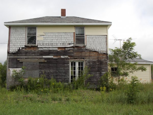

    Here are some pictures of what we are starting with...NOT MUCH! But we can hopefully make it work. In the meantime, I mentioned our move (250 feet East) and putting up our house for renton Facebook, and in 20 minutes time I had (3) people who wanted to rent our home. I don't thinking renting our home will be an issue.

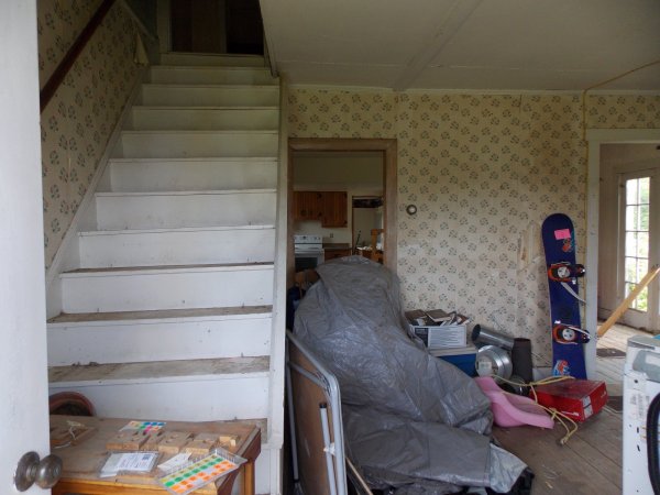

    A few from the inside...

    It may be small but you will make it work. At least you have a structure to work with. I hope you get most of the work done before you move in. Interesting siding layers on the outside.

    Yes, interesting is one word to describe it.
    Trust me, the vinyl siding is coming off! This lifetime logger is not about to have a thousand gallons of oil pumped out of the sand halfway around the world, hauled over here, squished into a form, and then nailed onto the side of my house under the false pretenses of protecting it from the elements. My uncle was a carpenter and his standard operation was to cover every house with plastic. He was so bad he was going to put vinyl siding on his cedar shingle mill building until I told him there had to be a law against it.
    Me...
    There is no way I am going to have an oil rig puke all over the side of my 1890-1930 Foursquare Home, not as a lifetime logger in the most forested state in the nation. They say "vinyl is final", but that must not be taking into account wind, sunlight, and extreme cold. Not to mention vinyl does not add even a single R-Factor to your walls like cedar shingles or clapboard's do.
    Thankfully the cedar shingles under they vinyl siding are in excellent shape, they just needed to be painted, so my uncle clad the building in siding-puke instead. But this makes it easier for me, because it means I can remove the siding-puke, just put new cedar shingles where we ripped the additions off the house, tuck them underneath the exiting shingles, then paint the whole house. I dislike painting shingles because eventually it peels, but when that happens I can just reshingle the entire house.

    Different climate I guess. My Mom's house has had painted shingles for 65 years and they don't peel. The paint just fades.
  17. Canadian border VT
    19,842
    132,391
    LodgedTree piece of advice, do not paint, Stain, stain now comes in many colors, when it wears out no scraping, wire brushing gets tape paper to Windows and re-spray much easier!!

    Yeah that is sound advice; they have come a long way with tinted stains.
    Myself, I like the look of natural cedar shingles, but it is not perfect because if a person puts in a new window, loses a shingle and splices in a new one, it looks like a wart on Tiffany Amber Theisen's face. (Okay, so I am giving away my age here, but it still makes my point; the repair of raw wood is glaring against the gray weathered shingles around it.
    On my Grandmother's house I have little option because they already painted it. I cannot stain over paint, and right now I do not want to reshingle the whole thing. About the only options I have would be to:
    1: Shingle just the areas void of siding then paint the whole house so everything is matching
    2: Shingle the whole house and leave bare to weather or stain
    3: Sandblast with Walnut hull medium the old shingles currently on the house, and then leave to weather or stain

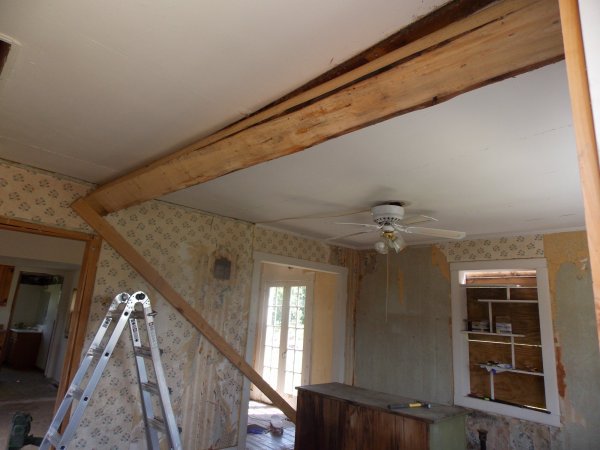

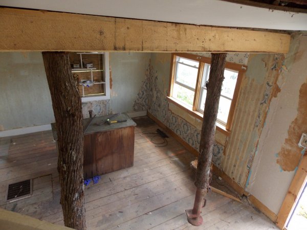

    Yesterday I was pretty proud of Katie, we not only had to put some permanent cedar posts in the basement to help level the upper floors of this old house, but we had to put some temporary ones in there too so that the jacks above would transfer their loads to the ground in the basement. That was because the second floor was sagging something awful. Some 75 years ago, someone had the bright idea to remove a load bearing wall leaving no header at all, and no support for 2x4 floor stringers spanning 18 feet.
    To get the 2 inch sag out of the floor, we had cut an 8 x 8 beam, 12 feet long made out of spruce. Putting one end of the beam on a skateboard, and lifting the other end with my log loader, I slid the beam into the room. Then using 2 x 4 ramps, we slid the beam into place, then rolled the beam up using (2) 20 ton jacks, then repositioned the beam and jacked again. We had enough tonnage on the jacks to press the sag out of the floor and probably for the first time in 75 years, the floors upstairs, and the first floor ceiling are flat.
    After that we slipped in a 4 x 8 inch post under the beam along the walls, we removed the jacks and had very little settling. In the written word it does not seem like much, but an 8 x 8 inch beam 12 feet long is darn heavy.
