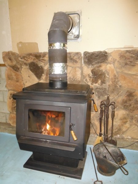

    Looks like maybe you put new pipe on at the stove Bogy ???

    Old picture, still have same pipe as in pic
    Just took new pic:

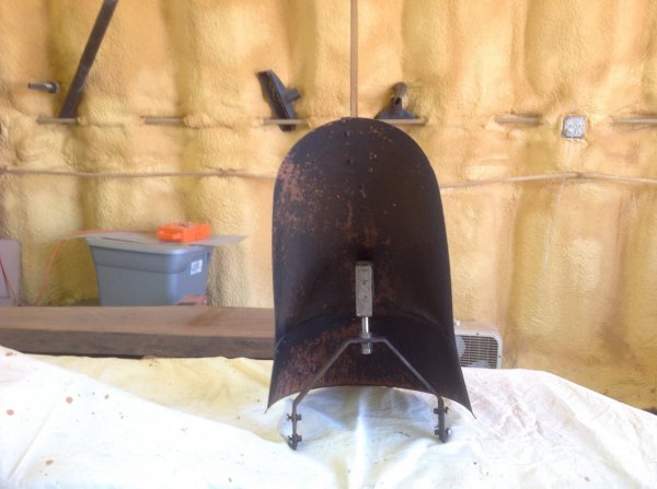

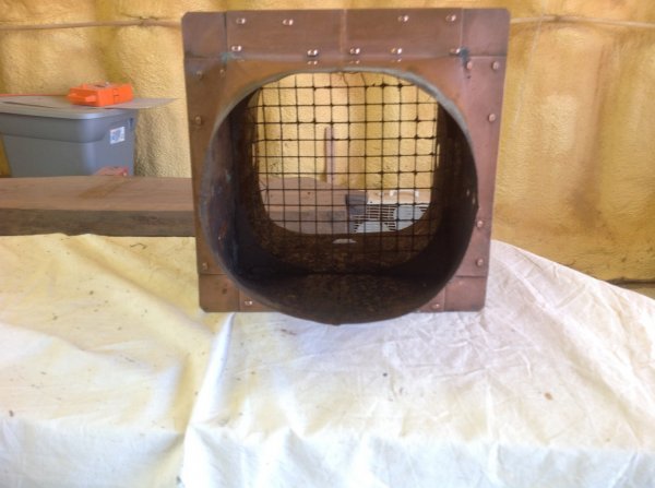

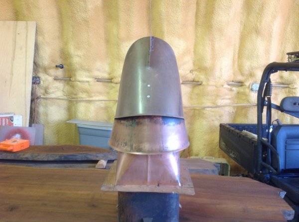

    Had similar problem at my old house in suburbia. Neighbors house to my northwest was only 15 feet away and was taller than I could make my chimney.
    Sometimes even with a blazing lava hot fire in my Lopi I would get horrible downdrafts. Tried everything, extended chimney,various caps nothing worked all the time.
    Ran across this cap which FIXED MY problem.
    New house does not need it & I have been meaning to sell it here if I can donate the proceeds to FHC.
    Handmade.
    Solid Copper.
    Stainless frame.
    Top rotates on a bushing.
    Very rugged.
    Farmers will recognize the design.
    Bottom section .
    I like & left the patina but it will shine up like a new penny .

    Ah.....I didn't see the joints wrapped like in this picture that is why I thought it was new
