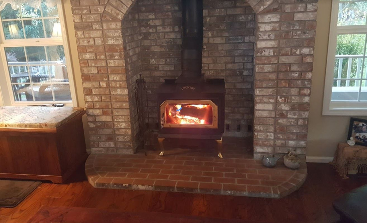

    Buzz Benton that's a great, post, thanks. Say, your stove and hearth is really attractive. Sorry... questions!
    What stove do you have? What made you come to choose that one? (I know little about stoves.)
    Your heart includes an area that looks somewhat like a huge fireplace, is it a fireplace or made for a stove?
    At the back of your 'fireplace,' there are empty spots where bricks were left out, what is the purpose of that?
    If I were to ever have a stove, I would want a large glass window like yours because I want to have the ambience of flames.

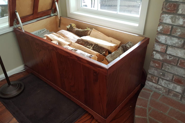

    The box to the left of your stove, is that a wood box? Curious how you have wood with ready access and keep it clean like that.

    Howdy! I can answer most of those questions for you.
    That is a Legacy™ Model SS260T-B, by Country Collection, since bought out by Lennox, I believe. It came with the house, built in '96, but I would replace it if I didn't like it so much, that style is known as a "T Top" and inside it has a secondary burn system using tubes. People here call them tube burners, as the tubes port fresh air to get a cleaner burn. If I replaced it, it would be with a similar steel stove with a big glass window like this one has, but with a catalytic burner system. A lot of guys here seem to like the stoves made by the Woodstock Stove Company, and they have a line of steel stoves, catalytic, with soapstone inserts. That would be my pick now-a-days. Here's a link.
    The hearth was made specifically for a woodstove, and the brickwork is especially as a heat-sink, although it does not store heat to dissipate slowly as well as I would like.Yes, those empty spots you see convect cool air in through the bottom and draft warm air out at the top but are just out of sight, again, well intentioned, but not perfect.
    Yes, that is my woodbox, I built it exactly for that spot. However, I am green with envy of anyone with the "pass through" system that allows them to load through their garage and then access it directly from inside. I carry wood in, every morning, in a canvas satchel that zips closed and has a shoulder strap. It is less than ideal, but clean enough to come through the front door. Hiding behind the woodbox is my little dustpan and broom, I keep it tidy most days.
    Thanks for asking!
    My woodbox holds about two days worth of wood most of the winter. Newspaper and kindling in the far right side.

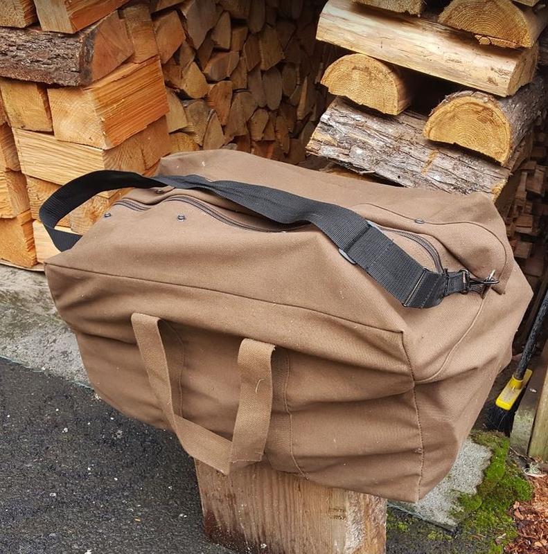

    Here's my current wood bag. It works fine, but others have much better ways to get the last 100' to the woodbox.

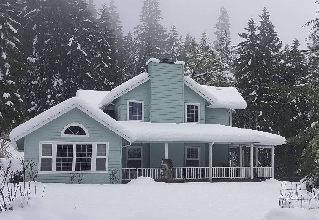

    From this angle you can see the "chimney" is just an insulated metal flue boxed in with framing.

    Buzz Benton
    Sweet setup overall. Cool alcove stove install with a beauty home in the woods. Very nice.

    NY West
    Buzz Benton awsome hearth you have there, very cool. In our next house a alcove for a free standing stove is one of my dream projects. I say dream because I’m not a mason and I’m sure that to hire one to come and convert a regular fireplace into something like that would not be cheap. So until then it’s a insert.
