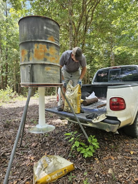

    We built a tripod feeder several years ago, the old spinner finally died. Decided to change it to a free flow style. Got 2 3" toilet flanges, 18" of pipe, long carriage bolts w/fender washers, nuts and a pizza pan... 20260808_131351.jpg
    Worked great, deer, coons and pigs loved it... 016578002026554-62-3-08292026001443-V-SYFW00337.jpg 016578002026554-58-3-08292026051456-V-SYFW00397.jpg 016578002026554-54-4-08312026033041-V-SYFW00485.jpg

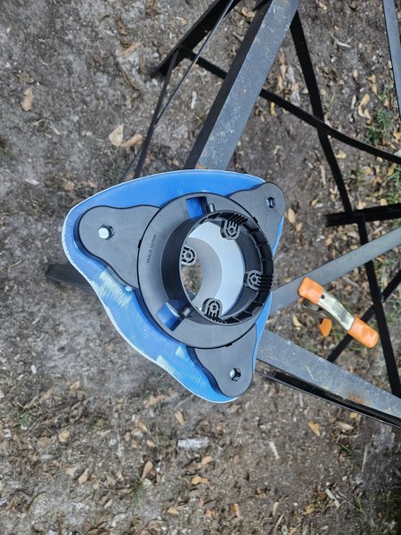

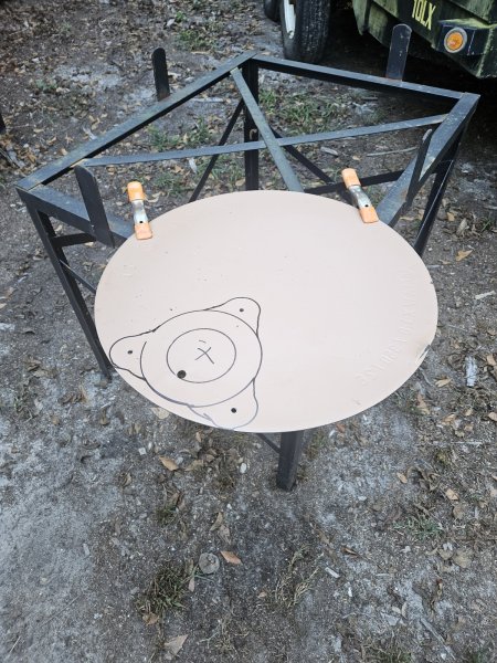

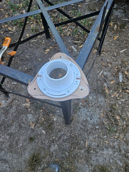

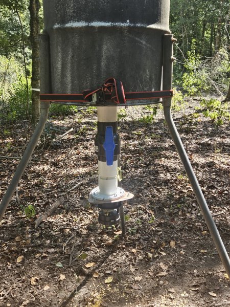

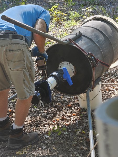

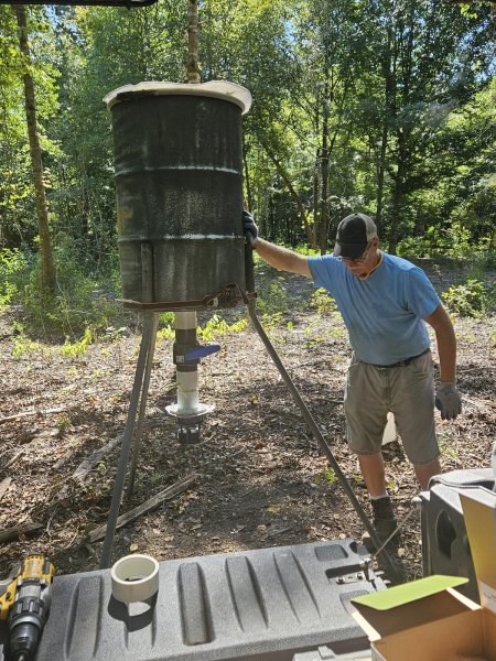

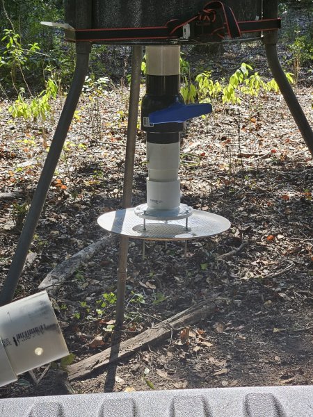

    We got the corn out, tipped it over and got valve installed 20260901_102530.jpg

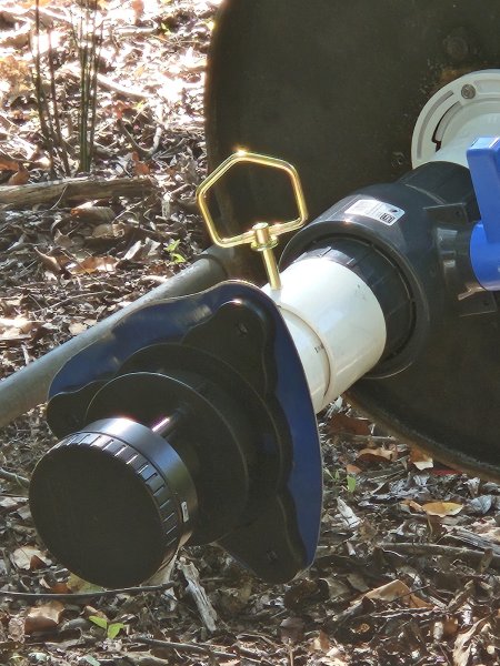

    Glued a short pipe with coupling to valve. Left other side of coupling dry. Glued a short pipe in flange on spinner, it slides into coupling, drilled hole thru both 20260901_103414.jpg
    And used 3/8" hitch pin to hold it... 20260901_103446.jpg
    Then we drilled holes in the free flow pan for after season use... 20260901_104054.jpg
