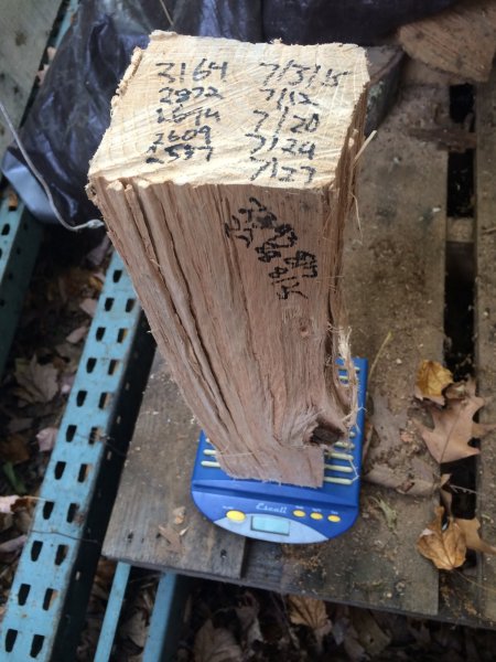

    Definitely have what you are seeing here too.
    This piece of red oak came off the stump on July 3 and was split the same day.
    Was 3164 grams. Now is 2229. 2229/3164 = .7044. Just a little less than 1/3 by weight.

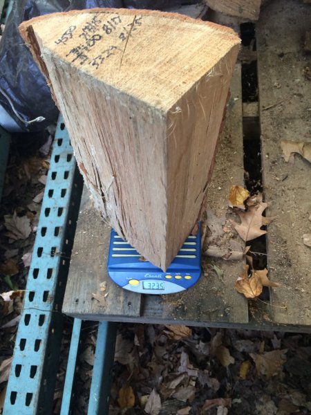

    Another was 4550 and now is 3235 or .709.
    Pieces from July 30 have dropped about .20 by weight. So they are over halfway there in 5 weeks. But it does slow way down.
