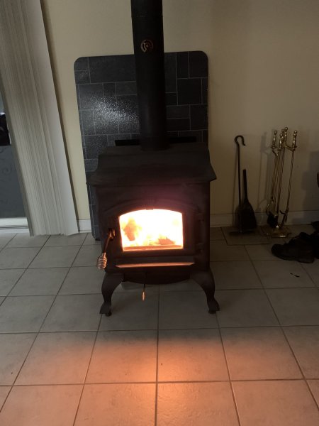

  5. SteveWest
    SteveWest
    Jan 18, 2020
    71
    372
    Western Maryland
    Well here are some pictures of my stove setup:
    Single wall pipe through the ceiling & roof. (I wish it went outside and then up the exterior of the house since wouldn't be such a mess when I cleaned it).
    Is this really single pipe after it goes through the ceiling?
    Do you have a chimney damper installed? NO
    Any suggestions?
    Chazsbetterhalf, Chaz and Marvin like this.

  7. chance04
    chance04
    Mar 7, 2015
    476
    1,081
    Denton Md
    Can you see up the flue from inside the fire box? If so you will want to look into a soot eater. Cleaning from inside has never been more convenient.
    Flue damper, can you choke the fire down to slow motion flames in the fire box or i's it alway's a raging infirno?
    Chazsbetterhalf and Chaz like this.

    Hey SteveWest It should connect to a thimble through the ceiling and roof.
    Not sure if double or triple wall is required.
    A key damper installed will definitely help you get a handle on the stove control, but could be a PITA during clean out.
    I don't have a "soot eater", traditional steel brush. Cleaning out my wall thimble can make a bit of mess, but chimney itself is cleaned from outside.
    Chazsbetterhalf and Marvin like this.

  11. Woody Stover
    Woody Stover
    1,261
    3,046
    Southern IN
    It's above the tubes, #9. Looks like two pieces. The baffle board retains heat in the re-burn area and routes the smoke past the tubes to be burned. Check that they are intact, and pushed to the rear..otherwise smoke can bypass the tubes and go straight to the flue exit, robbing you of heat.

  12. Woody Stover
    Woody Stover
    1,261
    3,046
    Southern IN
    You don't really want that; You're better off with a straight shot up for the best draft when it gets warmer out and you don't have as strong a draft. For cleaning, you can substitute a telescoping slip connector to the flue exit, then just slide it up and attach a plastic bag and sweep down into it from the roof. Make sure it telescopes smoothly when you install it, because they can be tough to slip when they get a little dirty..
    The connector pipe should be attached to a ceiling support box, then it should be Class A chimney from there up..
    Chazsbetterhalf, papadave and Chaz like this.
