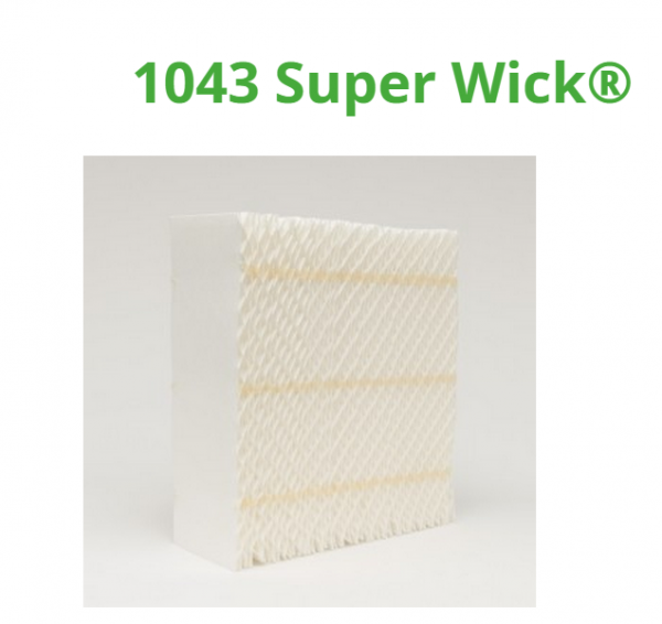

    I learned a lesson recently the humidifier Wick in the machine is important.
    I tried using last years Wick as it looked to be in pretty good shape.
    Even though it was in good shape I sprayed some bleach on it to sterilize it.
    Well the issue is the minerals from the water builds up in the Wicks.
    This inhibits the water wicking up in it.
    I noticed the machine not needing water and the humidity of the house was lower.
    I changed filters and big difference as the new Super Wick filter made huge difference.
    The old filter looked clean but was like petrified at the top of filter from the lime build up.
    Over half the filter wasn't getting water .
    My Humidifier uses a high performance wick thats like 280% higher performance than old type filters.
    http://www.essickair.com/humidifiers/ep9500-pedestal.html
    Important point if you use my type humidifier:
    There are other filters that work in this machine
    but you need to use the Super Wick version with the higher performance.
    Too get the same humidifying effect.
