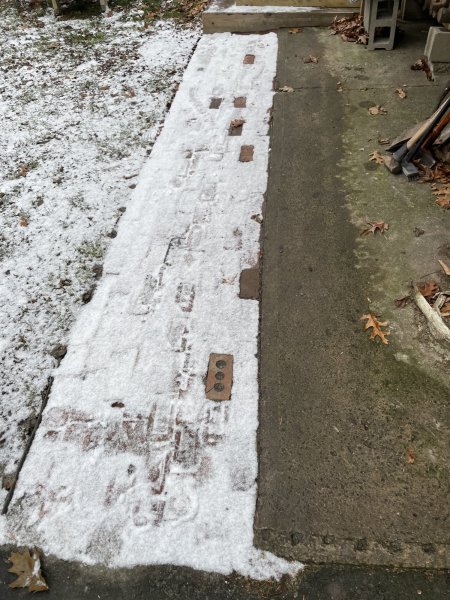

    Here’s a funny unexpected outcome of building this with randomly scrounged bricks. Looks like some of these hold heat more than the rest:

    Hey that's interesting! I wonder if they're darker and absorbed more heat from the sun?
    Did it shovel well (we havent gotten any shovelabls snow here yet)

    I thought either it’s holding more heat, or the bricks absorbed some kind of salt somewhere along the way. Kind of strange. As far as shoveling goes, I’ll have to wait until we get a real storm to find out. We only got a good dusting here in Bristol. Being that a lot of bricks are pitted, I’m guessing I’ll be shoveling the bulk of it but then sweeping it off with a stiff bristle broom, before throwing salt down.
