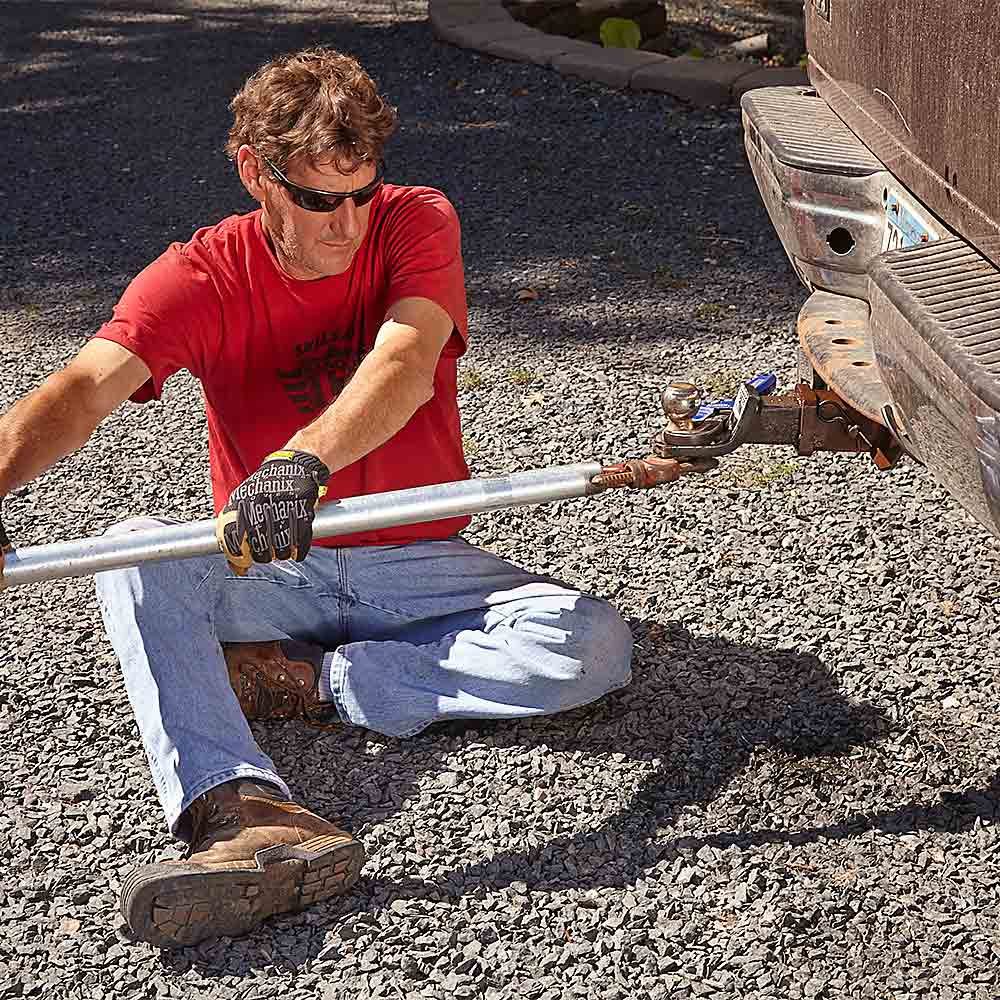

    yeah that's what I'm talking about, pull from the side on the wrench or bar on the wrench

    Forget the WD-40 on the threads, that will be gone in the blink of a eye. Fluid Film will work a whole lot better and last a whole lot longer. Best bet is some never-seize grease on the threads, just don't get any on your hands. Grease up the threads, install and tighten the nut and then wipe off the excess on the exposed areas.

    Fluid Filming the inside of your receiver tube works a whole lot better than greasing it. Grease picks up and holds a lot of grit which tends to seize up the hitch tube inside the receiver tube. The other great thing about fluid film is that since it is lanolin based vs. petroleum based, you can spray a little on your hands to prevent those dry, winter skin cracks that your hands develop.

    Just for anybody else reading this thread, an air hammer (with flat face hammer bit in) can work wonders with this stuff. Tie/chain the hitch to something immobile, have the wife sit in the truck with it in D, (if you have three pedals you're gonna have to get a bit more creative) while you put a whole bunch of vibration to the hitch. Those millions of little blows can do a lot more work than a few big hits.
    thewoodlands if you really want that ball off the mount, you might be able to cut it off with a cut-off wheel on an angle grinder. Even if you can only get part way through the shank, pound it off with a hammer/chisel.

    I've had some froze so much that a 1" impact with it heated wouldn't break free. Sometimes you just have to cut them off & move on.
