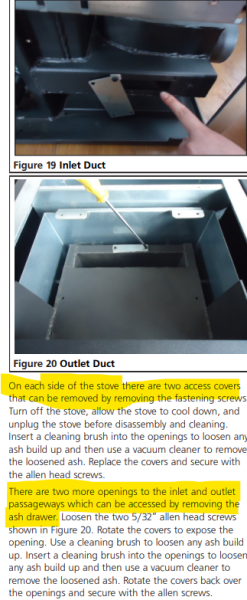

  8. yooperdave
    35,344
    221,469
    Are these the 3 small ash traps you are referring to?
    The unit is sold at menards and is their entry level pellet stove so yeah, it probably isn't long lasting.
    Bottom feeds all have augers to feed the pellets into firepots?
    brenndatomu, bogieb and wildwest like this.
  9. bogieb
    12,481
    75,857
    I highly recommend reviewing the manual for the stove prior to buying.
    I call them ash traps, they call them passageways. they are not what you have pictured
    Yes, that is correct.
