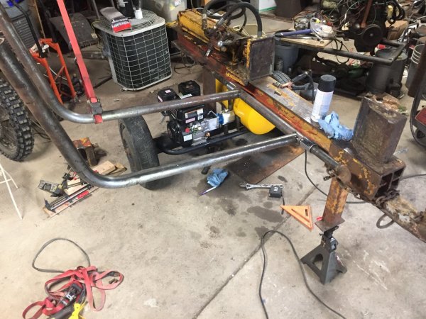

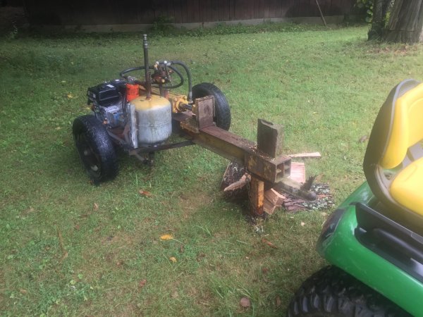

    so i picked up this turd last year for 200$ from a guy I used to work with. F9F5D439-5B52-465F-B838-9D9ECD072FA6.jpeg Needed a motor and a pump. So I bought a harbor freight 6.5hp and a 11gpm pump and got to splitting wood.

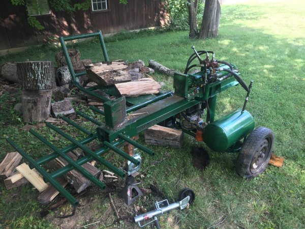

    Fast forward to two weeks ago my wife and I were splitting wood and sheard the bolts off the slide on s big chunk of Osage. So that prompted me doing some modifications to it that I’ve wanted to do for a long time. Me being 6’5” I wanted a taller splitter. So I chopped it up and made the top of the beam 36”. I can’t wait to split with this thing being taller. Bending over all the time really killed my back. E9A3AE5F-36EB-453D-B182-EB949DB26DA4.jpeg

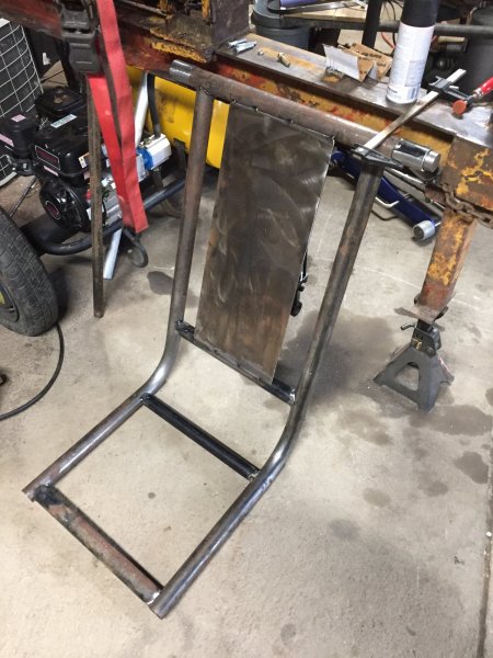

    737C4868-9CC5-4972-893A-DC514012BCDA.jpeg Got a little further. It was a hot one today in the low 90s. Slow moving but I busted out the tube bender and bent a few tubes for the lift arm. Made the shelf for the motor and the hydraulic tank. Tubing is 1.75 O.D. .120 Wall so it should be plenty strong. Haven’t decided how to fill in the center part of the arm yet

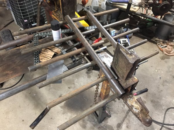

    Was out of town last weekend and I’ll be out of town this weekend also. So things have been slow. I might add a bar or two to the lift arm 097B2B50-B784-4EAD-85D5-386A0F06C757.jpeg

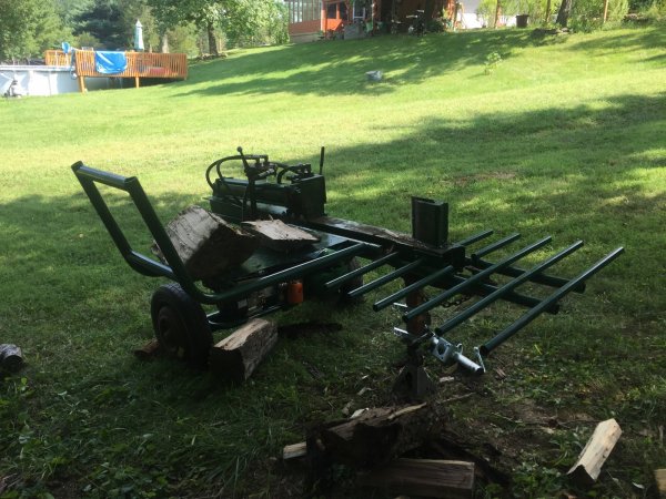

    Might I suggest putting some sheet metal 1/8" or so on the sorting table, it'll help keep wood from getting in between the bars and your ram from pushing said wood, bending your nice work.

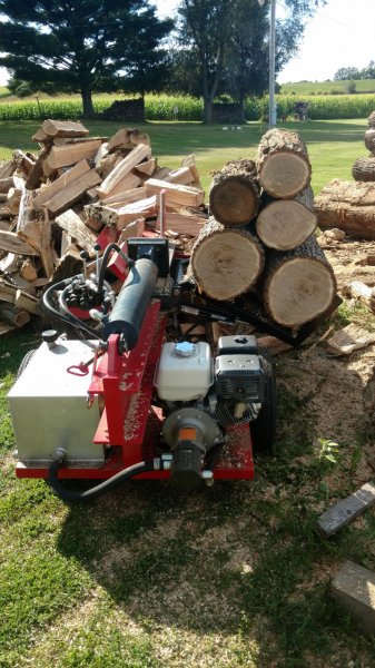

    Also throw an extra cross bar or 2 on your log lift. When you get your lift on and your valve body, you may need a reduced in the line to avoid launching the wood over your head. Even with a reducer mine is still pretty jumpy.
    Otherwise, looks great! Your going to love the log lift they are a great addition to any log IMG_20180802_165759068.jpg splitter .

    Ran out of gas for The welder. But I painted it and just had to try it out. So I took out out and split some big ole logs.. man the lift is SO NICE! So far it seems that I built the table low enough that it won’t get hit by wood when I split it. But if it starts to become an issue I’ll put some sheet metal on it
    Still gotta finish the jack and hitch. Also I’ll add a bar on operator side. I had a log come rolling at me :bug:.also some kind of a bar or something to the sides of the table. Had a few chunks slide of the side of the table. Maybe I’ll even find some new tires for it :D
