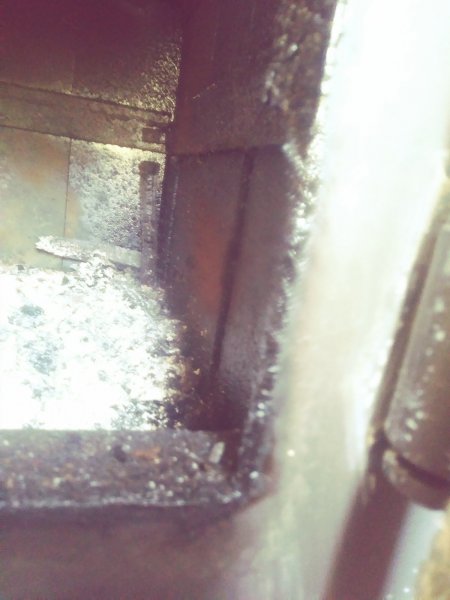

    IMG_20180906_123256755.jpg Well, it's prettier than the cat I took out
    Chimney sweep came and cleaned it all out.
    Time to screw the top back on, and wait on Mother Nature.
    Unsure if why the cast iron looks red. It looks redder than it is . Phone cam adds redness.
