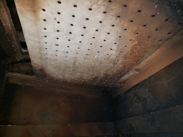

    the woodstock hybrids have secondary air, but not secondary air "tubes."
    there is a large plate in the top of the IS that has rows of 5/16? holes in it that let the air in over the top of the fire.
