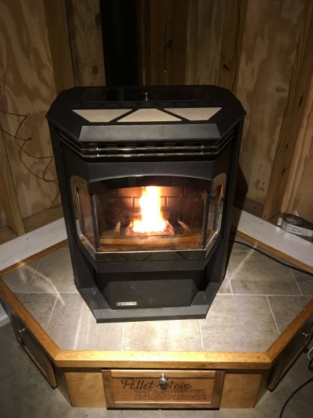

    Nice work Don! Is that the shop you made under your porch? That is gonna be a great looking place once you get it finished!
    Congrats and I wish you the best of luck with your business! You've come a long way and what you've done and accomplished? Is what many dream of! My hopes are to do what you've done.. one day!! LoL!

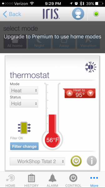

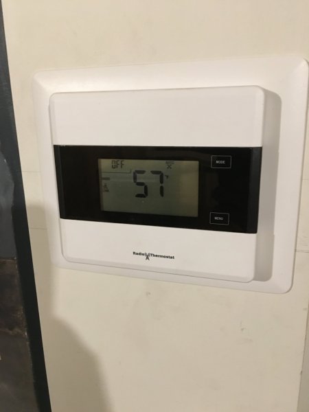

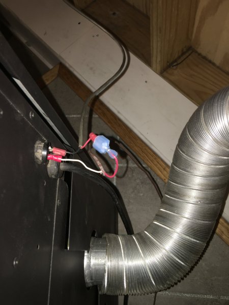

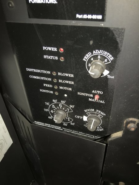

    I just got the Lows iris T-stat on it last night so I turned it on from my bedroom this morning to warm it up while I have breakfast
    Basically, I set the stove to room temp and the temp dial to 70 and then to turn the stove on, I set the iPhone to 95 degs and watch the room temp go up on my iPhone. The Harman will regulate the room to 70. Then I can shut it down or the Harman will shut down if the outside gets warm during the day.
    In the cold days of winter I can set the Harman auto/manual switch to manual and the Harman will go to a low burn after the room warms up just like other stove with hi/low or I can still shut it down when ever I want with the iPhone.

    That set up works exactly opposite of my thermostat - I set the thermostat to my set temp (72) and the P43 is set at 80, Room Temp.
  6. don2222
    don2222
    Nov 10, 2013
    3,444
    4,892
    Salem NH
    With your setup, the stove may stop & start more because the pellet feed is on high trying to reach 80 degs. The Harman service bulletin states to do it this way. The pellet feed varies to keep the room at the set temp on the temp dial and the stove will still shut down on a hot day. I first thought of doing it your way and it does work. How do you like it that way?
  7. bogieb
    12,603
    76,660
    Works perfect. Feed rate is on 3 (as it was before I installed the T-stat). Not much stopping and starting and doesn't use much for pellets. But, a lot of that may have to do with my circumstances and where I have placed the thermostat. And of course when in negative numbers I switch it to stove temp anyway because I don't want it to shut down at all. If your set up works well for you - great!

    So far it is working fine, I like to turn it on when I am on my way back to the shop from a job with the iPhone and see what the shop temperature is on the iPhone.
    Thanks for your comments.

    DON, I am wondering what those "doors" are on your hearth sides? I see 3. (one has the wording)

    Salem NH
    Just for extra storage. I do not like to waste space. :)
