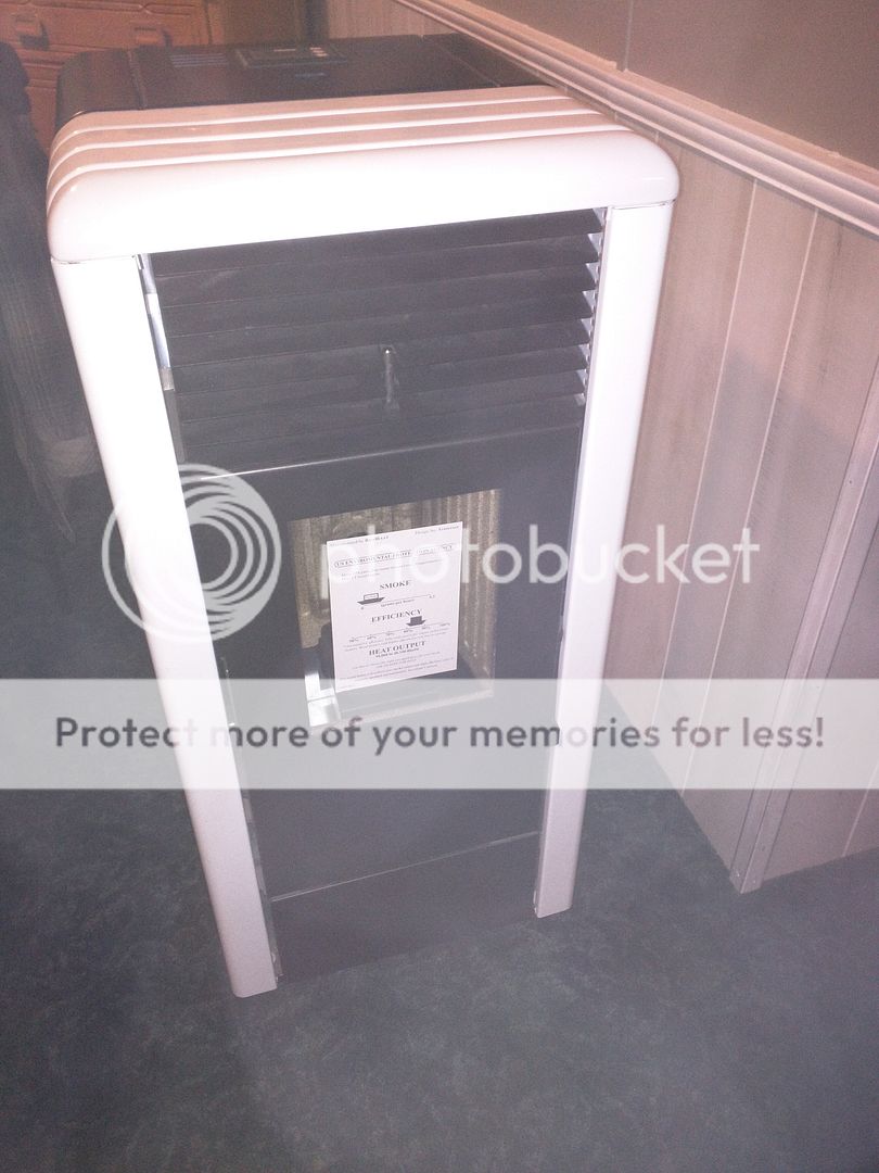

    No the Serenity is coming out,Iwill tell that story once I get the Francesca up and running

    It's in the house

    re: up and running, I know you know what you're doing, and always lots of help here @ FHC, but if you have any 'Francesca' specific questions you want to bounce, give a shout, I'll try to help.

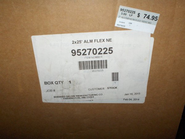

    Question 1 for you cleanfire, what did you use for the oak mine is currently 2" and the Francesca is much smaller.The stove came with the exhaust adapter but nothing for the oak.

    Hi Rich,
    This is from helping a member on the 'other' forum ... Used a thin, empty, stainless steel container, punched the top cap to slip-fit the OAK pipe, cut off the bottom, cut some vertical slits up can so it would compress, and fitted the bottom slits into the aluminum OAK pipe.
    Used high-temp aluminum tape to wrap the OAK pipe to the bottom of the can, used the same tape to dress the top opening to fit snugly on the stove.
    This way, I can remove the OAK pipe as needed for cleaning.
    Quoted post below:
    Stove was running yesterday, couldn't get pics. Here they are:
    Pic 1 is the air intake on the back of the stove,
    Pic 2 is the slip fitting opening on the adapter pipe,
    Pic 3 is a side-by-side of the adapter, and original of the container used,
    Pic 4 is a just disconnected shot through the stove back cover,
    Pic 5 is the (saved) original box the 2" aluminum flex pipe came in. purchased at Ace Hardware (Hamshaw Lumber, Keene NH).
    Pic 6 is a full size of 5 so you can read the info.
    * You should put an OAK on your stove, regardless on whether you route it to outside air, or several feet away from the stove inside the home: the Francesca models use a tangential fan for room air: at higher speeds, the room air fan -will- affect combustion air being pulled into the stove, so even if you don't pull in outside air, add the OAK pipe and route to a room location several feet away from the stove that will not be affected by other air sources ( cold air return / heater ducting, etc. )
    Hope the pics help, good luck w/ your install,
    CleanFire

    Thanks, good idea I will see what I can come up with

    I still have that extra can here, and I can store the product in another container - if your OAK line is 2" / you want the container, let me know and I'll ship it to you. :yes:

    Well its installed but tried setting up the RDS and nothing is happening
