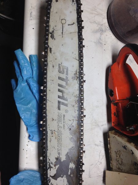

    So I'm doing a little work on a 460 for a guy and as part of my normal process I clean & sharpen the chain (20", 3/8-.063 for what it's worth). As I was sharpening the chain I realized something very odd about it.
    For the most part it's a normal full comp chain. Then I run across the section of it shown in the photo below. Now, as we all know, a standard chain alternates right and left hand cutters separated by one link. My understanding is that on a half-skip chain they alternate between one and two links between cutters. On a full-skip chain there are two links separating each cutter.
    On this darn chain there is a section of about 14 drive links that is all right-hand cutters and they're separated by THREE links each!?!?!?! Has anybody seen anything like this before?

    Looks like that chain has a couple sections in it. I wouldn't run it.
    Someone either resized it or replaced sections at one point.

    I agree.. That is a handmade loop of several chains.

    I agree, but what a lot of work to piece together that sort of section! Three separation links and all RH cutters? I don't think you can buy anything close to that? Also, and I could be wrong, but none of the rivets looks to be 'homespun', but I'm not expert. Not to mention there's also a yellow painted Stihl strap in the middle of the mess...
    I'll certainly tell the guy I wouldn't run it. I don't think he's very knowledgeable with chains to begin with . . . the cutters were crazy dull and as little of the cutter as you can see is left the rakers had never been filed. No idea how he cut at all with it...

    Are you sure some were left hand side ones were not broken off. I run into that occasionally when the cutters are near the end of useful life. I do have one customer that got some chains from somewhere that are mixed species per loop - 3 different mfg . didn't catch it at first thought something went south on the grinder.

    That's a very good thought and is what I suspected at first as well. I only looked quickly, but I don't think that's the case. I'll look closer this evening.

    Look to the right of STIHL on the bar, and slowly look at all of the rivets as you go up, a few of the tie straps that are installed where LH cutters should be have larger spun rivets than the regular chain. Definitely pieced together

    Seen it on trade ins. Looks bad to the eye but couldnt tell any different in cuts. Wood had no clue. Use it up IMO.

    I've not had the pleasure of getting a chain quite like that one in. Looks like it would cut circles. Now I want to go knock the left cutters off half a loop and try it. :rofl: :lol:

    That right side is a section of full skip but why would you piece chains together? Just seems like a waste of time to me:picard:

    Frugality, after a bunch of reels ya always got a short sections left after making loops, might as well usem. Not my practice but it's out there.

    Well, just as a quick follow up - after a very close inspection the LH cutters have not been broken/ground off, so it didn't start out as a section of full skip.
