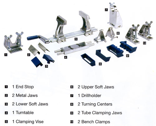

    A lot of my cuttin is done in the back yard , if it's nice out I clamp my zyliss vise to the picnic table , if not nice, I do in the shop , If I do go cut somewhere I have the stump vice and take 3 saws
    Zyliss Vise

    That looks quite nifty!

    It is very versatile and strong , that's only part of it ,here's the rest
