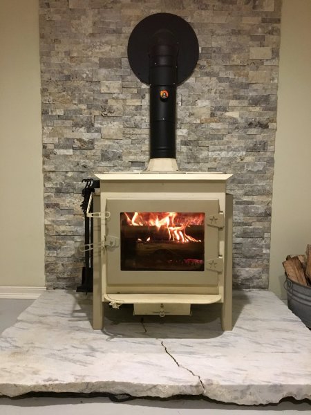

    49,197
    314,073
    Our Fireview is on a 16" raised hearth and the firebox door is 9 1/2" from the top of the hearth, so 25 1/2" from floor to bottom of firebox door. We find this to be ideal for this stove. We sit on a chair to load the stove.
    The IS with the legs fully extended is 15 1/2" from floor to bottom of firebox door. With that, it would seem to me that a 12" raised would work great.
