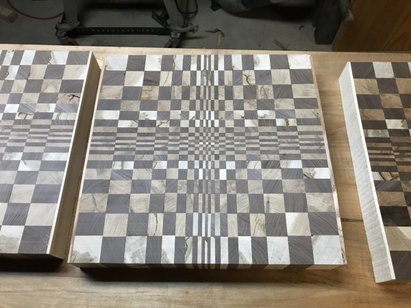

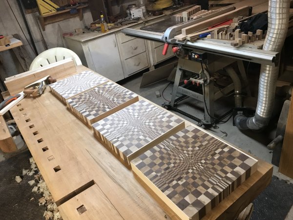

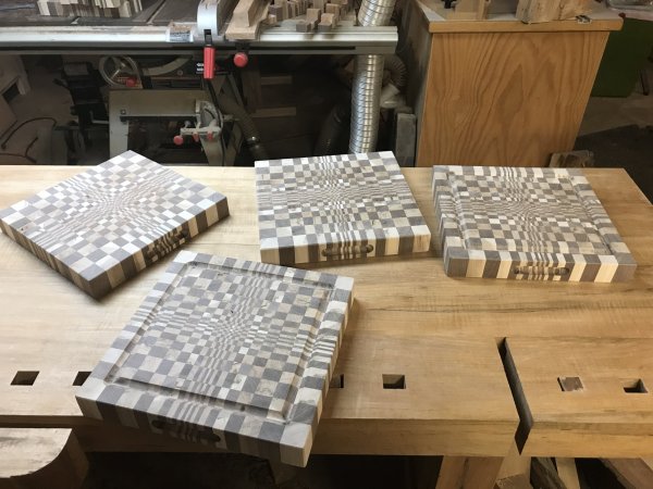

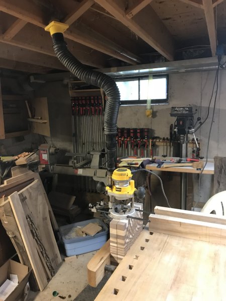

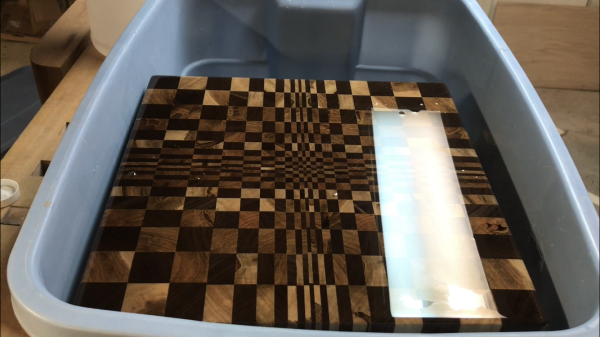

    Finished up the cutting boards. I’ve got one last video to upload too.

    They look great Shawn. Do you use anything to fill in the small cracks and voids?
    Looks like some kind of oil bath to permeate and preserve the wood.
    Can't wait to see the vid.

    Nope, nothing to fill any cracks/voids. They add character. :) Once it’s all oiled up real good it seals out water quite well. I’d be more worried about the wood putty coming loose later on in the food or something.
    It’s a mineral oil bath. Food grade mineral oil is a better choice than most food oils which can spoil after a time. I recommend treating it on a schedule like you would for cast iron: one a day for a week, once a week for a month, once a month for a year, then at least yearly after that or whenever it seems to need it.

    As far as the food grade mineral oil, that just makes sense also.
