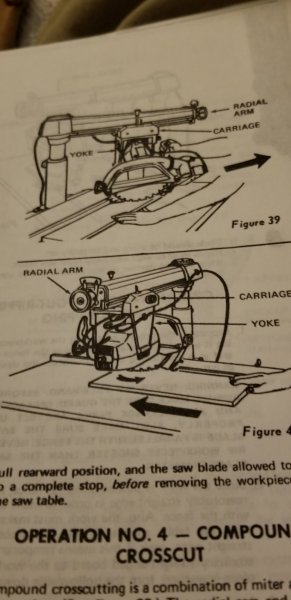

    I think it’s important to note that the direction of the teeth in this orientation is vital. If one is facing the teeth and they’re coming “at you” the material will be grabbed and very swiftly ejected out the other side.

    It is all in the manual if one chooses to read it.:salute:
  11. Eric VW
    23,607
    133,427
    20 years ago when I took ownership of my grandfather’s Craftsman 12” radial arm saw from my dad, the manual was long gone, and I had never witnessed either of them rip with it.
    So alas, first time for everything. :yes:

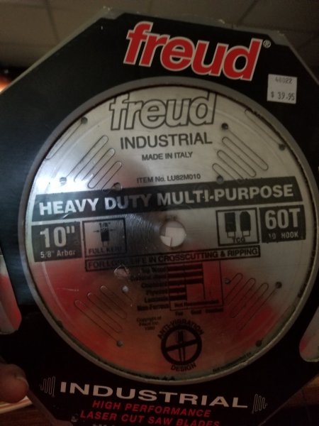

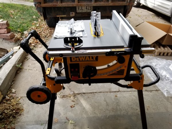

    After a lot of research, seems like DeWalt was the winner so picked this one up today. Need to do a little adjusting but should fit the bill for my needs. Now to try and finish some projects. I do want to thank everyone for the advise. Also found this new blade that came from FIL before he passed.

    Enjoy your new saw. Thats a nice blade also. Be safe.
