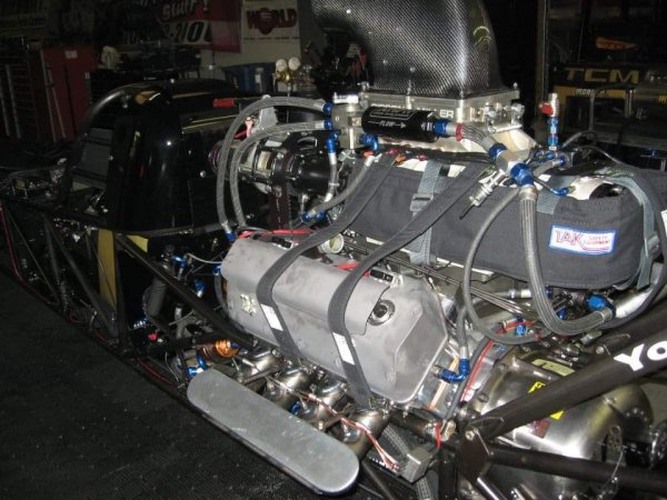

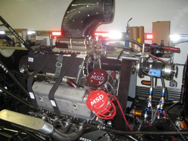

    Nice gear!! 1200HP should be fairly easy.
    What ya got going on with the fuel system?
    Compression Ratio?
  2. buzz-saw
    buzz-saw
    Jan 31, 2020
    4,940
    29,033
    Ct.
    Two fuel systems mechanical injection( just methanol) , one into the blower to help keep it cool and the second into the intake runners. Nothing out of the ordinary, this is going to be bare bones old style seat of your pants kind of fun.
    Compression static is right around 10:1 , depending how much blower gets thrown in will decide the final number. I don't want to kill it.
    Still work to be done but seeing light at end of the tunnel.

    Ahhhh.. One fuel system ( pump & barrel valve ) with 2 sets of nozzles. Over & under..
    With 10:1 downstairs, it should live a long time. Get after the blower overdrive and let the blower do the work.

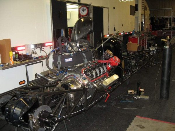

    Thats the plan anyway. 8:71 on that combination should get me more than what I need and still not have to spin it to the moon. When I started I figured 6:71 was enough and it probably is for what I am trying to do but don't want to work things at their maximum. Now I have room to play.
    I have two options. I have a powerglide based two speed and also a Lenco. Not sure what my final decision will be. I have mounts and linkage for both.
    If I can get thit thing to go in the sixes @200 I would be happy.
    My last front engine dragster ran mid 7"s all day long and had a lot less than this thing, so the possibility is there.
    As many times as I said I am done it just keeps coming back to haunt me. Right now, I still enjoy it so just going to ride the wave.

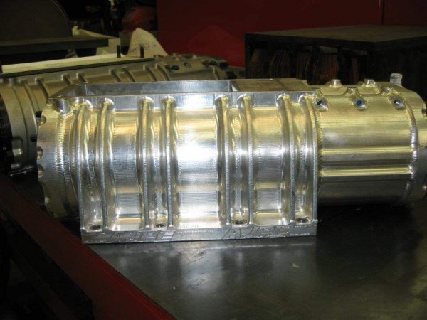

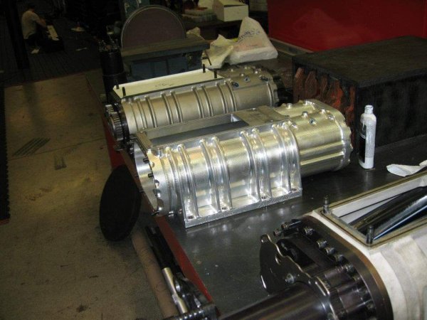

    A few engine pics from the race shop.
    Billet 14-71 blower cases

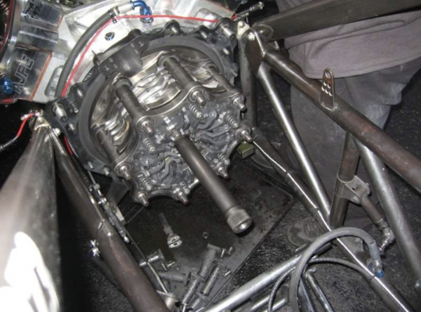

    5 disc lock-up clutch.
