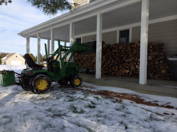

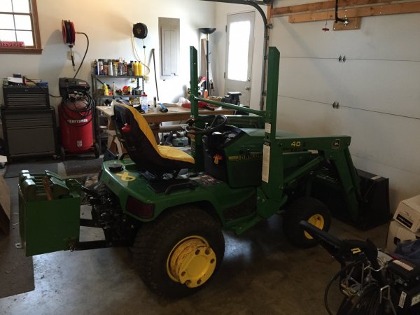

  15. Trilifter7
    Trilifter7
    457
    822
    Waynesville, OH
    Yea it really is! I've been able to do a lot with the 445 and it has made a lot of jobs much easier.
    It does everything I've asked it to, but a cat 1 hitch, 4wd and double the lift capacity would be a huge upgrade for me.
    I've not had any issues with my turfs on it either, but if R4's don't tear the yard up or slide around too much plowing I would like to go that route with the next tractor.

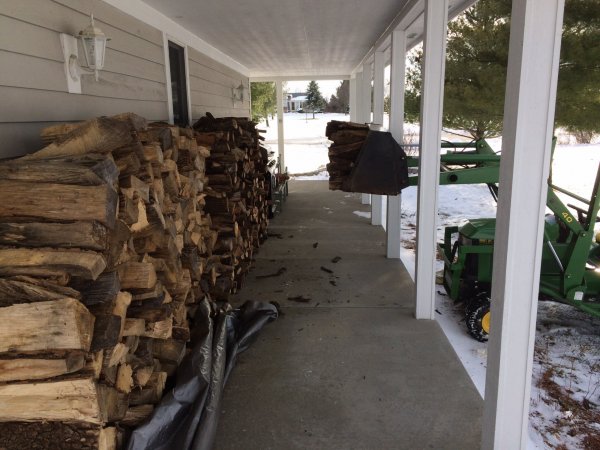

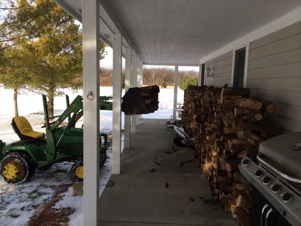

  18. Trilifter7
    Trilifter7
    457
    822
    Waynesville, OH
    Thanks Cnice! It's part of what sold us on this house. It also makes for a great wood storage area in the winter! :axe:
