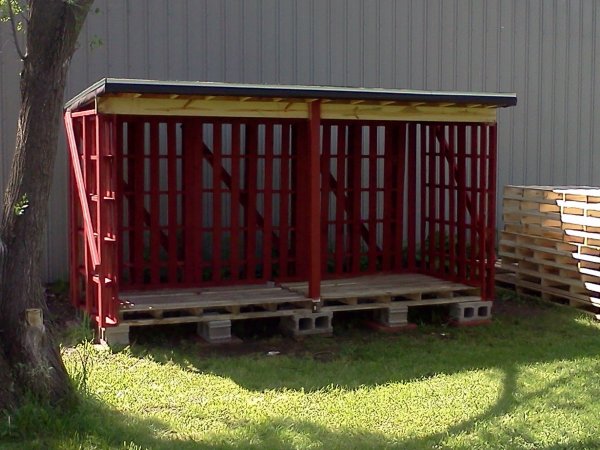

    Thats a nice shed you have WES468 Nice job indeed:thumbs: I found with mine setting it on blocks made it last forever without any rot at all.. If you decide you like it that may be something to consider for the future.

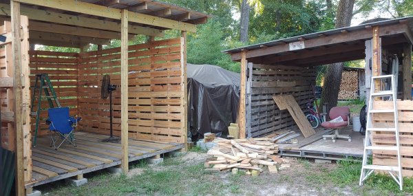

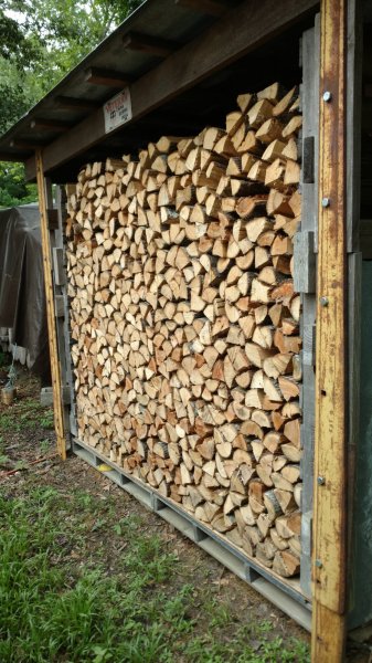

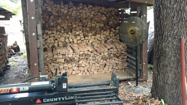

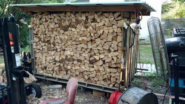

    Here are a few different styles of pallet wood sheds we have built.
    These pallets are 50x50 each, floor and sides, holds 2 cords total. 0306201724.jpg
    This is a little shed we built for kindling/limbs wood. The floor is a 5x10 pallet, sides are 48x48 pallets on the bottom with half pallets on top. 0214201027.jpg This is a single shed, built with 50x50 pallets. It will hold 1.25 cords stacked to the top. IMG_20190628_190428767.jpg The shed on the right is 7.5x6x14. It will hold 5 cords. 0705200737.jpg IMG_20190619_110234825.jpg The shed on the left side is 11x15x8. It has 2 7.5x11 skids for the floor and 48x48 pallets for walls. It will hold 9 cords. Has 3 cords of hickory in it now. 0825202237.jpg For the chunks, shorts and uglies, we have built a couple plastic pallet bins. 0120201201_HDR.jpg 0120201223_HDR.jpg
