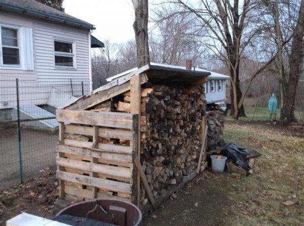

    Running out of room in the big wood shed so I put this together last week.
    2 pallets for the bottom, 2 for the sides, some 2 x 4's for the roof, cover with tar paper and
    some role roofing, done, all stuff I had lying around. Probably holds a bit more than 1/2 cord.

    When your in a pinch and need to make some room for dry wood storage, pallets sure do fit the bill and no major dents in the wallet. Nice job, PP would be proud...

    Whatever it takes to keep it dry. Quick and easy. Nice work

    37,208
    SWEET!
    Off the ground, good air circulation, top covered :thumbs:
    Dry findable wood !!

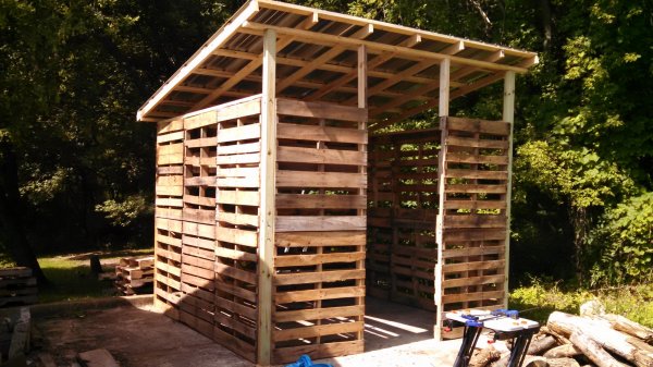

    Nice! I've got a couple like that and one like this: IMG_20140815_113744_313.jpg

    When I built the above shed I spent a little over 200. I purchased the 4x4s and 2x4s brand new. The roofing is scratch and dent steel pole barn siding I bought @ Menards. If I had had more time to scrounge I could have built the whole thing for free or just the cost of nuts and bolts. The 22 pallets were found much like everyone has mentioned here. If you decide to go this route I would be happy to answer any questions you might have.
