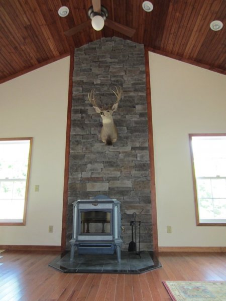

    Three years ago, when I decided to install wood heat, my wife and daughter wanted a fireplace because they are more attractive in their opinion. They specifically detested the idea of having a "big black box" in the living room and wouldn't hear of it. I refused to consider installing a fireplace in a house that never had one due to cost and inefficiency.
    After researching I learned about the soapstone stoves and found the metallic blue Fireview for a good price in good shape locally on CL. When they saw it in person they dropped their opposition to wood stoves because this one was aesthetically pleasing to them. It's been a great stove but just didn't put out enough BTUs for our drafty old house.

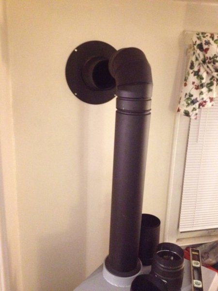

    Well problem número uno rears its ugly head. My Supervent DSP double wall stove pipe kit's adjustable pipe is way too tall for this very tall stove with top vent option. I think if I drop the adjustable legs to their lowest height I might be able to squeeze this in.
      File size:
      142.2 KB
      Views:
      9

    Question; why are you running a 90 instead of two 45s?

    That's what came with the Supervent DSP double wall stove pipe kit from Lowes:

    Well, I'm stumped. I can drop the adjustable legs to their lowest height but it still won't fit with the stove adapter in place, way too tall overall. The top section of the long adjustable length vertical DSP pipe might work without the stove adaper but its not very tight/secure on the 8" to 6" collar adapter. A crimper might fix that and I can borrow one as needed. I could cut down the long adjustable length vertical DSP pipe and still use the stove adapter but I'd rather not cut it.
    However I'm still too far to the right of my class A flue thimble to mate up with the DSP pipe. So ... I just sent off an SOS to Woodstock:
    Hi Tom and Lorin,
    Again congrats on the victory in DC! Hope you all got home safely. It was a pleasure to meet everyone there.
    I have a question about clearances and I'm not sure where to direct it. Hopefully the attached photos will help explain my question. Our Fireview was a very simple corner install at minimum permitted clearances with a rear heat shield. With the rear vent and stove facing straight out from the corner our thimble for our class A flue was set pretty deep into the corner too.
    With the top vent and increased height of the new stove I'm running into trouble making the double wall stove pipe coming off the new stove top vent meet up with the outside flue on the right rear wall...
    Tom in DC you said the clearances to combustibles with the new stove were far less than my Fireview. If I can safely move the stove another 3 inches further back into the corner I can get my double wall pipe to mate up with the thimble. Plus it will give me better coverage in front of the stove with my hearth pad for ember protection. I can pick up an IR thermometer to monitor temps at combustibles.
    If I need to increase the clearances I will probably need to switch to two 45 degree elbows to achieve some lateral offset to mate up my double wall stove pipe with my class A flue at the thimble.
    Any advice? I received the 8" to 6" reducer in the mail today and we are itching to fire this thing up ASAP.
    Thanks!
    Brian
    dsp thimble.jpg ​

    I had a similar issue installing my telescoping pipe, itwas too long by about 4". Simply take it apart (pull the two peices apart), and cut one side the required amount. Cut it about 2 or 3 inches shorter than required so you have some adjustment room. Then put backtogether and re-install.

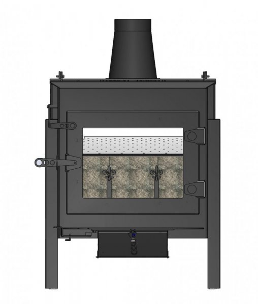

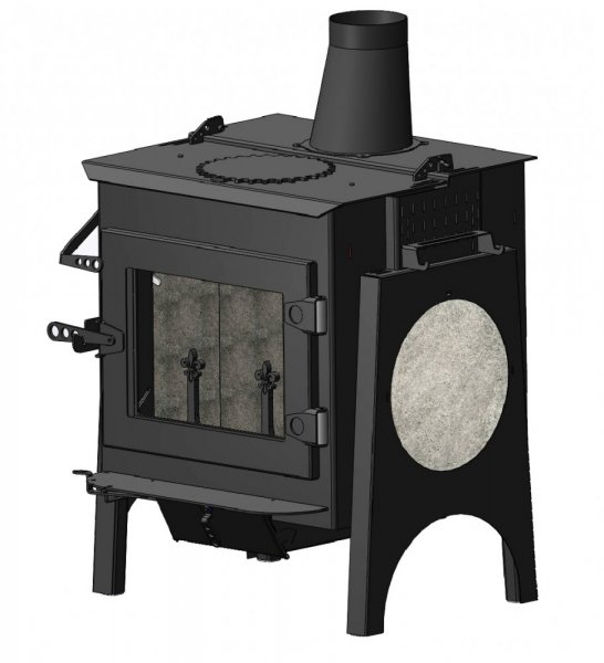

    Here's a rendition of the new stove in basic black that Lorin just forwarded for anyone interested. Sides and andirons and other details can be changed as requested:
