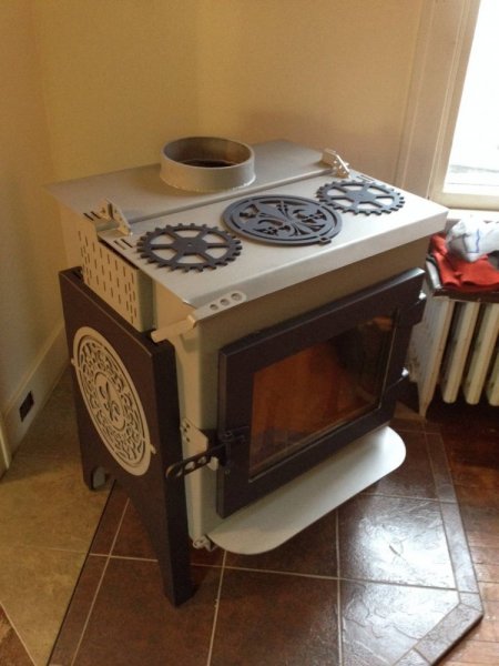

    I suspect that would be an option because the flue opening is 8".
    My Beta stove has a permanent 8" collar, but that is not going to be how the production stoves are made. I am fairly certain that the production stove will have a cast 6" collar that reduces from an 8" opening for improved draft and can be either top or rear vent. See their illustration vs the top of my Beta stove.

    Just wondering if the 8" collar was just for testing purposes. I remember the drawing of the cast flue collar.
    I assume it will be certified with 6". Just curious, in case someone wanted to replace a BKK someday :whistle:
