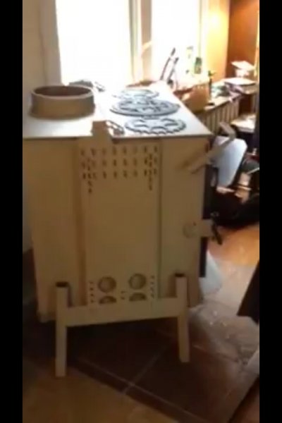

    Yes, they are adjustable. The outer leg cover hangs on the structural steel legs. They have about 5" of height adjustment. Look at the video I posted about removing the leg covers. There is an H shaped structural steel leg at the bottom on the side behind the leg cover that can be adjusted up of down by removing 3 bolts.
    Here's a screen capture from the video:

    Ah, okay, so they bolt onto the sides and can adjusted for height to a certain extent. Cool.
