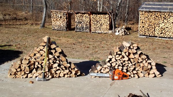

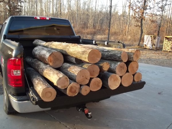

    It wasn't until I retired and moved north that started getting into wood. The first thing I learned was that axes are not really the best tool for splitting wood, I don't have access to really big stuff, most of the wood I get around me is less than 18" across. I started with axes but quickly moved on to a 6lb fiberglass handled maul... much better! These pictures show the kind of wood I usually deal with... A lot of dead standing oak..

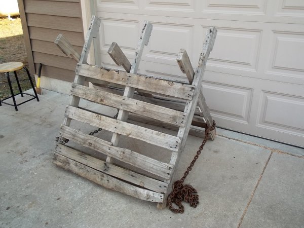

    I made a saw buck out of a couple of pallets and it's worked great for years...
    I throw the logs on there and cut to length.
    When I first stated my firewood adventures, I had an old, finicky, Jonsereds 49sp, my wife insisted I buy a more modern saw. I knew I didn't need a pro level saw, but I wanted more than a disposable saw. I got a nice deal on a Husqvarna 450, so that's what I've been using for years. I have't had to drop a live tree yet as I've been clearing out the dead fall in the woods behind our home.
    A couple more things to keep in mind as you gather your wood. Find a way to store it off the ground. There's many different ways to do that.... pallets, cement blocks with landscape timbers, plastic pallets, large wood sheds... I went with what I had access to, pallets, dump find tin, and scrap wood make nice drying racks.
    An inexpensive moisture meter is a nice thing to have when you're first starting out. I found on a Harbor Freight for $10.
    Split your wood as soon as you can, store it off the ground, give it time to dry in the sun and wind.....
