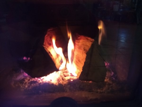

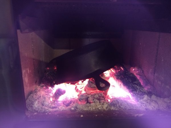

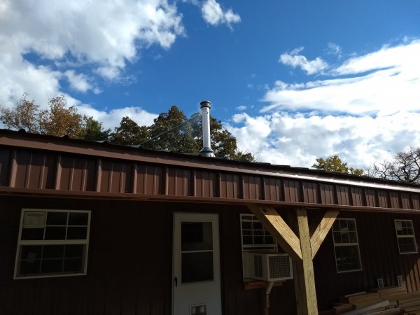

    It did well over night. Plenty of coals by 6 in the morning. the house still at 70 and the stove top at 220. Pushed the ash to the back and raked the coals to the front and middle. Set a couple of cedar splits on top for good hot cleaning burn. Didn't work quite as planned, the splits burned hot for a while but then petered out and instead of burning down the coals they added theirs. We had north east wind this morning and that means down drafts. The house smelled a little of wood burning and it did outside also. Took a couple of pics of the chimney but it is hard to see. However, the lovely coal bed didn't get wasted i put my new old cast iron pan on it to burn the crud off and it worked very well.
    Do you think it will be safe to burn some pine tonight. It's not quiet as dry as the other wood only around 16 to 18 but it has no bark. It's the only light weight wood i have right now.
