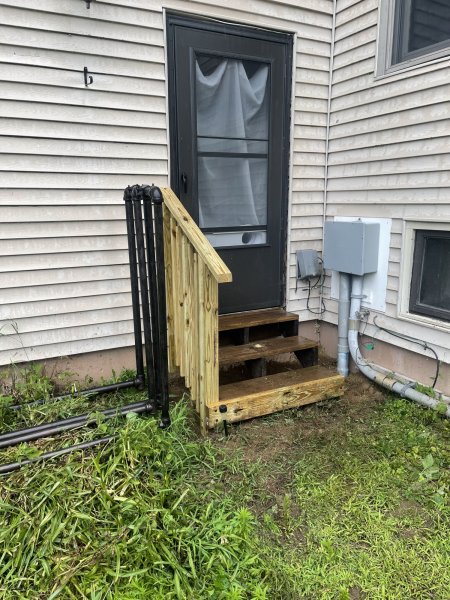

    I would like them but not at those prices; used BIP is free and shipping wrap is cheap

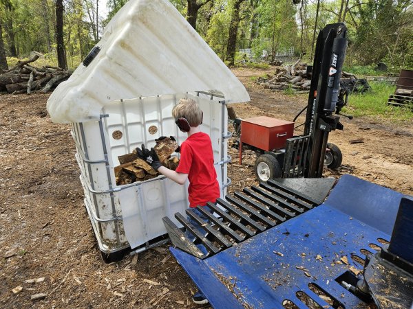

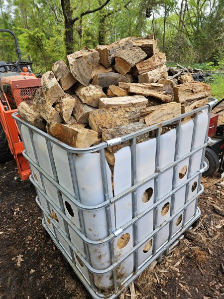

    Maybe the door is better visible here...we use short self tapping screws to hold to door plastic on... 20240403_115750.jpg

    Yes! I like that Idea! :cool::yes:

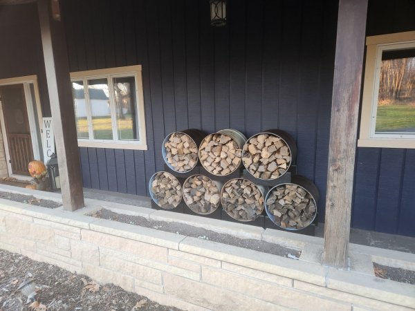

    You guys with equipment to move the totes around are lucky. With no equipment I'm relegated to stacking it in my main storage then when I need more at the house I fill up the gorilla cart and pull that up to the house with the ATV. 3-4 trips with the cart and my house storage is full. That last me about 2 weeks, give or take depending on temps.

    I like your house storage rack. 55 gallon drums cut in half, or what are those containers?

    Correct. 55 gallon steel barrels. I cut them in half, just use the top half and put an X brace in the back to give it some strength. The top of the barrel has the round lip that gives it plenty strength on the "front" edge. Then I cut some 2x8 for feet or stanchions for them to sit in. Just follow the curve of the barrel so they sit in there nice. Very stable...and bonus the wife likes the way they look...rustic decorative and all.
    I also rusted them with some vinegar and salt. Then sprayed them with poly to seal in the rust and prevent any further. They sit under a large porch eve so they should stay pretty good.

    What is BIP? How do you stack with this?

    MHL68 your barrel rack is awesome! Looks good next to a nice home.
