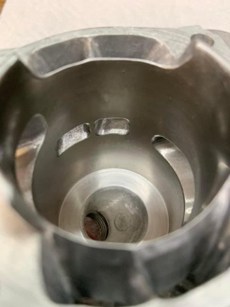

    Not really much difference in the saws. Main thing, 394 uses a dual port arrangement and a solid intake block while the 395 has quad ports and a rubber boot.
    Lot of guys say that dual port setup produced more torque. If it did, it isn’t a lot. I’ve run both back to back, ported and not ported. After porting, 395 is the winner IMO. But it’s not by much.
    Dual;
    Quad;
