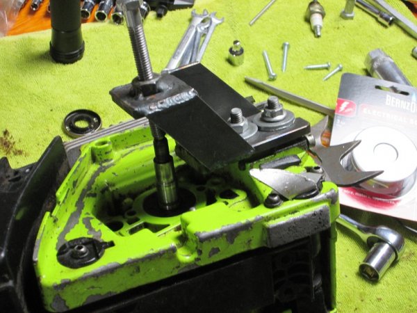

    The case splitter I made is from scrap steel. If you have a welder you can make one easy.

    I made them form scrap steel too no need to be inox or titanium , a cheapo welder and thats all

    Yep I have a cheapo welder. I can make it then.

    Yes you can the tube is about 12 cm the spindle is about 2cm longer than the tube and the plate is 13 cm long

    This is one I made. It can give you more ideas.
