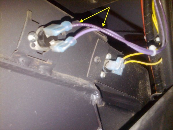

    The other thing as Snowy mentioned above is to jump the vacuum switch (just for testing) and also the #2 snap disk just to get them out of the loop. Basically, you'll be tying the wires together...MAKE SURE STOVE IS UNPLUGGED BEFORE DOING THIS...your're working with 120 volts and make sure the jumper ends don't touch any metal.
    Snap disk #2 are the yellow wires....disregard the arrows pointing to the purple wires.
