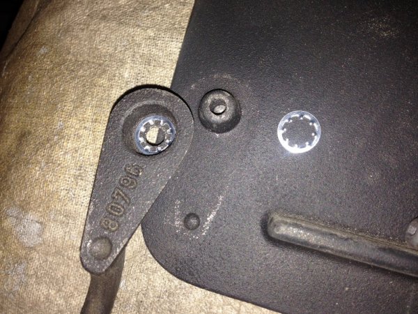

    Hello
    Nothing!
    At first I said Oh No! But it is a Quadrafire!

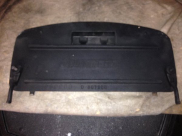

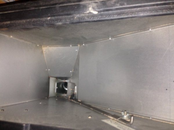

    Stove was working fine so I let it run dry of pellets and vacuumed the hopper. No bolt there!

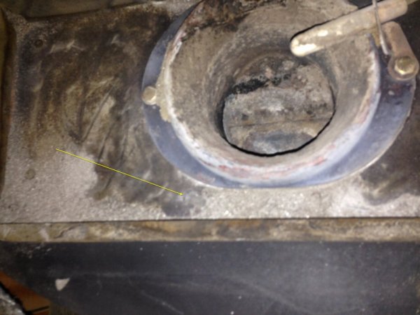

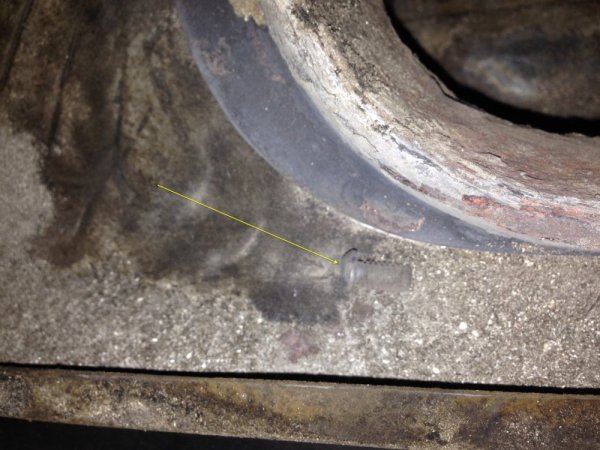

    Then I started vacuming the fire box and there it was! Right in front of the fire pot!

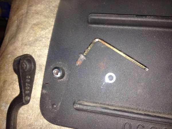

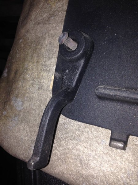

    So I tried star and C lock washers. The C washer was too think for the hindges to sit flush with the cover so I put in the much flatter star lock washers. Anything else I should do? Maybe some RTV?
    See yellow arrows in pics below
    Click to Enlarge.

    Liquid thread locker. Removable type.

    What imacman said..
