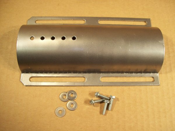

    JT...What is the adjustable auger plate you spoke of??

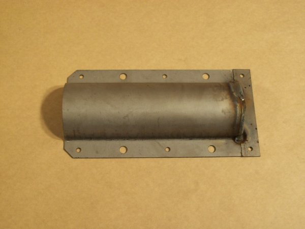

    Here's a couple a pics. 1st is the original the stove shipped with. With certain pellets it could actually produce closer to 70K BTU's and cook the stove. So enviro released an adjustable so the user could lower it if they found it was over heating even with the larger convection blower upgrade. See pic number 2 for the adjustable cover. I haven't done an upgrade, But believe it fits over the stock cover and allows the opening to be closed up to restrict the amount of pellets the auger can pick up. Lowering the feed rate and keeping the stove cooler. In most cases it wasn't needed, But installed and set slightly lower than the stock opening.

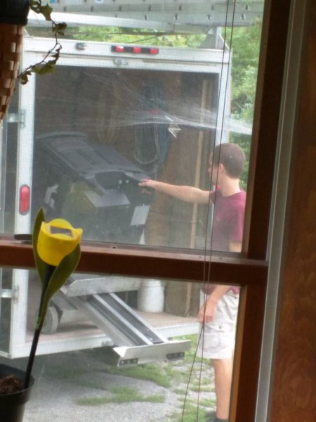

    The stove has arrived! Installer has a pretty slick automatic hand jack to being it in up the stairs without needing to lift. Will get an "after"/install pic soon.

    Ok, just looked at the stove while they are fabricating outside. Man date shows Dec. Of 13....will this have the updated cover jtakeman has a pic of above. Should I be concerned? What do I look for on the blower?

    Dec 13 should have all the necessary updates. You should be able to see the adjustable cover inside the hopper. The updated blower has part number 50-2481

    Yep, confirmed with installer, all upgrades are there. Checked the cover in the hopper and the new blower when he is installing the thermostat
