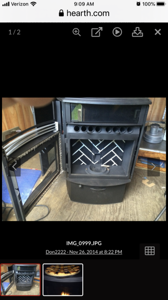

    The picture of the control box shows that it is the old version. The new clear control box that cork man has is the latest version that has a blinking amber light that comes on if there is a problem with the Thermocouple. If there is a problem with the Thermocouple the stove will not light so I would recommend checking that out. The welded tip under the white cover sometimes breaks and that is a common problem. Also the red and white wires must be connected to the right screw terminals and cannot be reversed!
    Here are some pics of my contour
    Can you post some more of yours? It may help?
